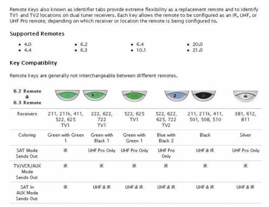

There is a special tab needed for TV 1 UHF Pro. All the tab does is slide a 4 position switch, so all you need is a small flat object to slide the switch to the correct position if you don't have the correct tab. TV1 UHF Pro tabs were difficult to find even back in the day.
