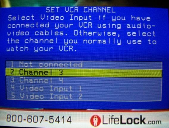

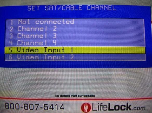

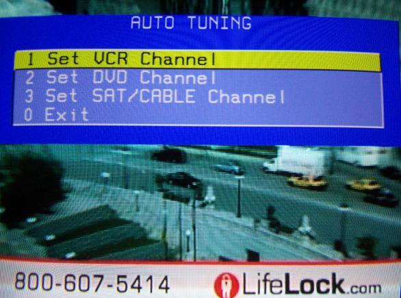

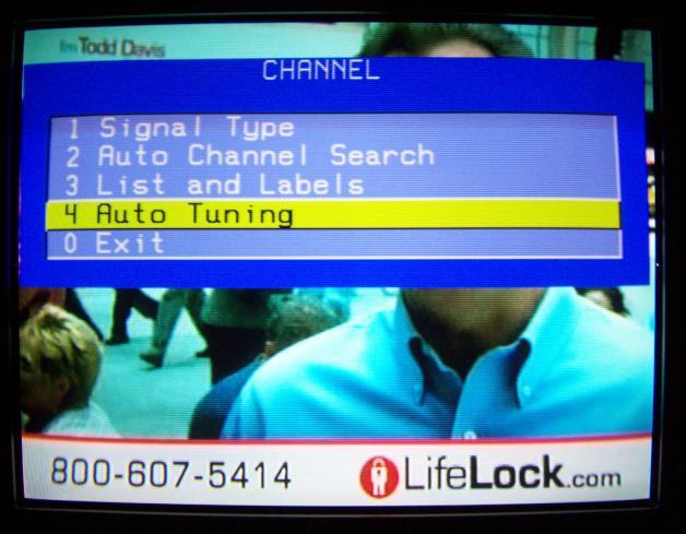

Here are the pics I was talking about.
Your TV may be different, but to on mine you go to MENU, then CHANNELS. Then select AUTO TUNE. Now you are in the menus where you can switch the input channels for the remote!

I was hoping I could turn it off somehow, what I did is change my TV so that both the sat and aux button (on both my tv and sat remote) change my TV to Component 2, the drawback there is I was using AUX on my tv remote to bring up the input for my PS2, also if I try to use my dish remote to adjust the stereo volume when I am watching anything other than Sat it will change to the sat input.
