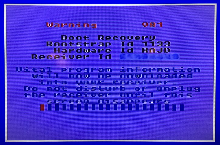

I came home from Thanksgiving visits with my wife's Family and the power LED on our ViP 211 was on. I thought that was odd since there shouldn't have been any timers for today. When I turned the TV on, it indicated no video detected so I yanked the power cord for a hard reset.
Instead of the normal "Acquiring Signal" screen, though, I got this screen instead:
In all my times of owning the 211 I've never seen such an 8-bit screen! It filled up the row of squares (I guess, each time I looked more were red and not blue) but now there is still no video output and I've tried to power-cycle it multiple times. It's dead, Jim.

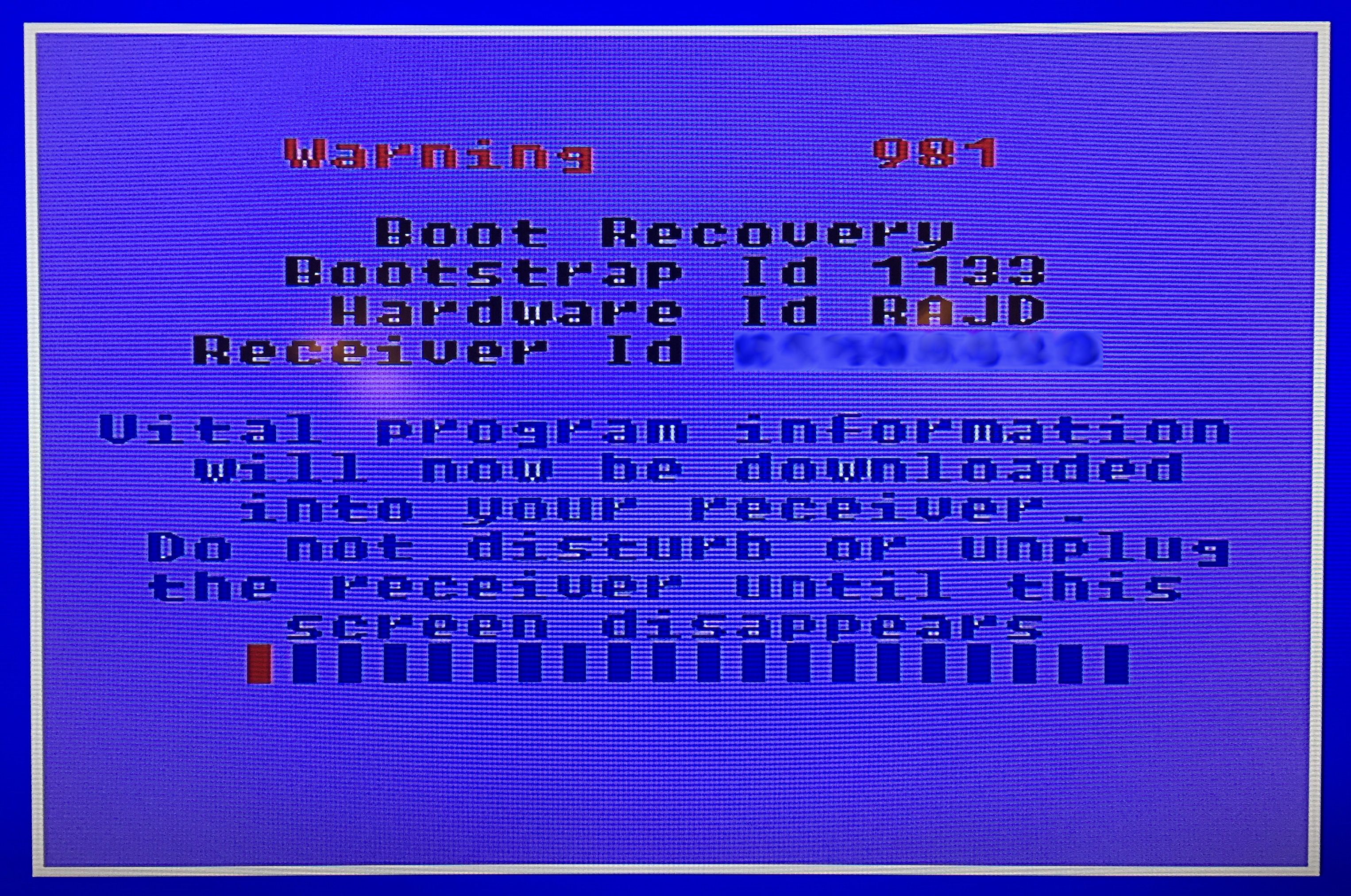

I don't see anything in your post after I got this screen instead. Error 981 should mean a software update (download) was interrupted. Often from a signal loss.

Sorry, I realized after I started that I needed to blur my Receiver ID. The Warning 981 screen is there now in Post #1.
We had a lot of heavy rain at home Friday and Saturday. If the update was attempting to download during that time frame, I could see how the download would be disrupted.
Now it appears to be a silver brick. No video, just the green power LED.
Okay, I yanked the purple SmartCard. No response. The unit is not outputting video, so there is no way to access any menus. I'm thinking it's totally bricked unless there is some "Master Rest" procedure to try.
I connected my old analog LCD monitor to the composite outputs and power-cycled the 211 without the SmartCard. It is finally showing video output! The 981 screen is attempting to download software once again.
Crossing my fingers...
It looks like that on all systems. It is the boot recovery message. If it has not resolved itself after 4 hours of uninterrupted alone time, then it needs replaced.

Even though the 211 filled the entire set of bars and restarted, coming up with the "bouncing dish" logo screensaver, it disappeared shortly afterward. After appearing to spontaneously reboot, it is now unresponsive, with no LED and no reaction to button presses. Sounds like a brick to me.
Edit: Oh, what you're saying is don't try to rush it, this process of "fixing" itself could take upwards of four hours? I'll try to be patient...
And now we're back to the "Warning 981" screen. So much for watching Dish tonight!
