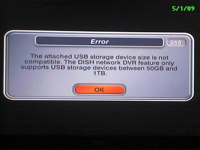

As for today, the quasi-DVR cannot handle HDD of the the size.

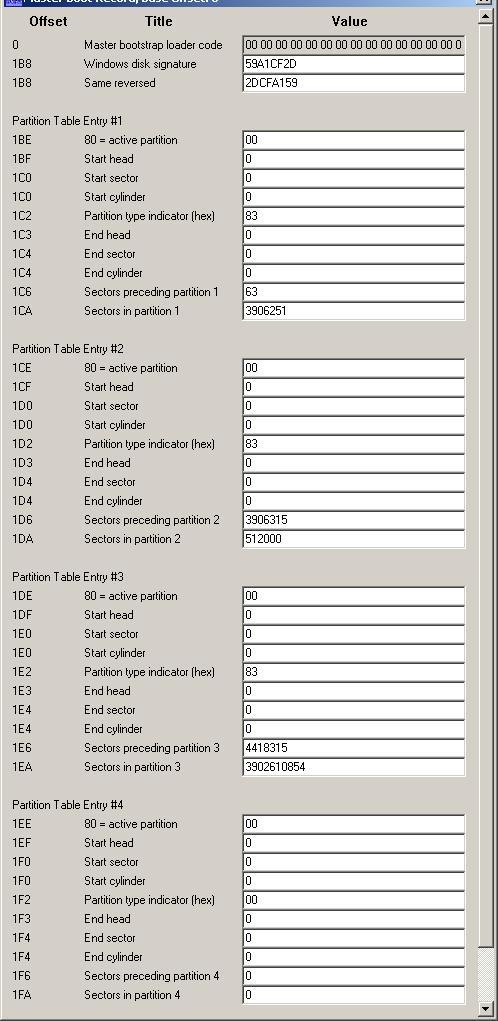

But the DVR Linux did format it properly, ther is part of log files from partition#2 [EHD]:
[DBG_GRP_MW]<mw_hd_api.c:901> <05/01 19:43> get_drive_capacity: 3907029168 sectors
[DBG_GRP_MW]<mw_hd_api.c:904> <05/01 19:43> Size in Gb: 1863
[DBG_GRP_MW]<mw_hd_xmd_format.c:49> <05/01 19:43> HD: Reformating External Main Hard Drive.
[DBG_GRP_MW]<mw_hd_xmd_format.c:75> <05/01 19:43> Going to format partition 0 and command is mke2fs -m 0 -q -jF /dev/sda1
[DBG_GRP_MW]<mw_hd_xmd_format.c:75> <05/01 19:43> Going to format partition 2 and command is mke2fs -LEHD -m0 -b4096 -TLargefile4 -i15261696 -jF /dev/sda3
[DBG_GRP_MW]<miniwatchdog.c:809> <05/01 19:48> Reformating of external hard drive done ....
[DBG_GRP_MW]<miniwatchdog.c:810> <05/01 19:48> Reformat finished at time ..................
is hdd made out of stacked drives?
It must be single disk. 2tb is available but still not mainstream.
If you did read quote from post above - "get_drive_capacity: 3907029168 sectors " ... WD20EADS
