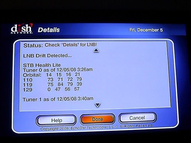

I have 2 HD TV's and recently got 2 VIP612's from Dish. They came out installed and within a day we were having problems with the picture cutting in and out. So now we have had 5 different technicians come out and try and fix this issue.
1st guy installed the new receivers
2nd guy installs a new LNB
3rd guy(s) installs a new dish, new LNB and changes out all the cabling as we found out the cables were bad.
4th guy changes out the LNB again because the 2 previous guys added the wrong LNB.
5th comes out and changes LNB again. (this was today)
This is from my bedroom Receiver
Status: Check Details for LNB
Device DPP44 Dual
Satellite 129 110 and 119
Orbital 14 15 16 21
110 73 71 72 79
119 75 84 79 39
129 0 47 56 57

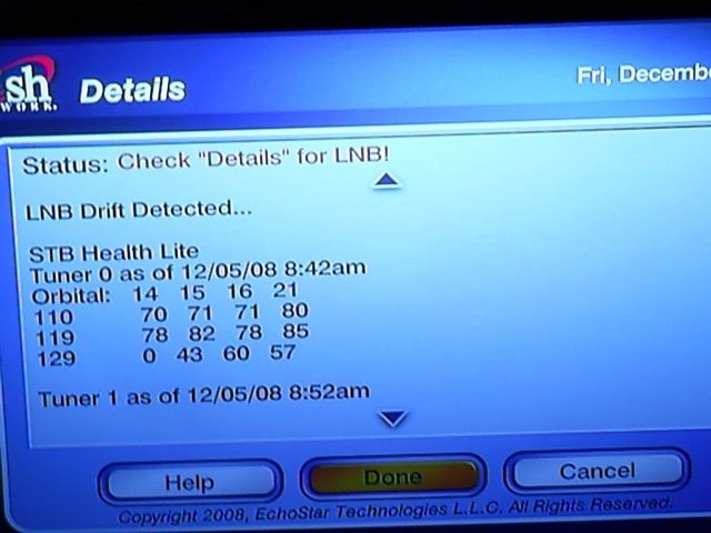

This is from my living room receiver
Device DPP44 Dual
Orbital 14 15 16 21
110 70 71 71 80
119 78 82 78 85
129 0 43 60 57
Why is the Status not staying at Good...why does the LNB keeping going out and why can't the techs fix it. I've not even had these 2 receivers a month and have had so much trouble it's getting annoying.

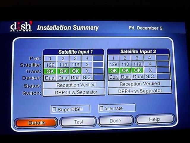

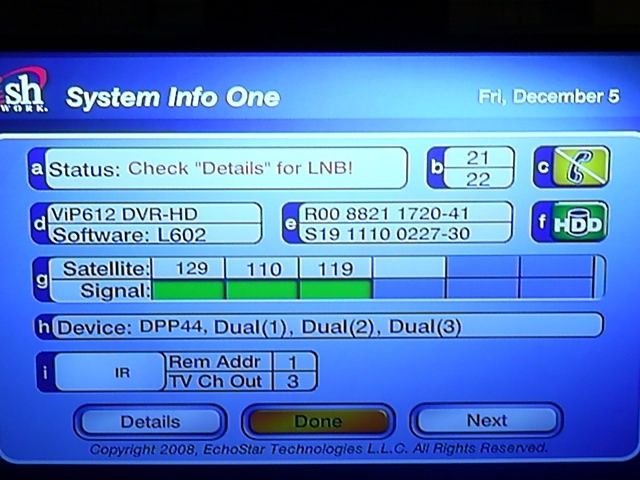

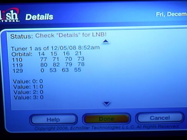

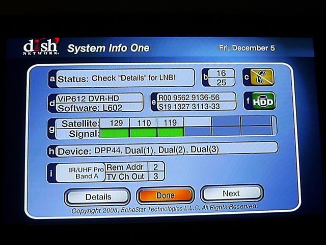

Post screenshots - one for main test screen, other for Details.
Sorry, I've been posted in almost ALL threads about "LNB drift" and can't accept your excuse. There are official document, technical tidbits and more.
I can't find anything that will help me in the other posts that will fix my problem. I've been searching for the last 30 minutes. Unless you can provide me a link to something useful then please do so.

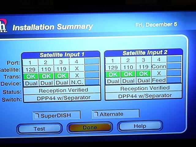

These shots are from the living room tv.
If I honestly don't have an LNB Drift..why does the picture cut in out on certain HD channels?

Living Room Shots

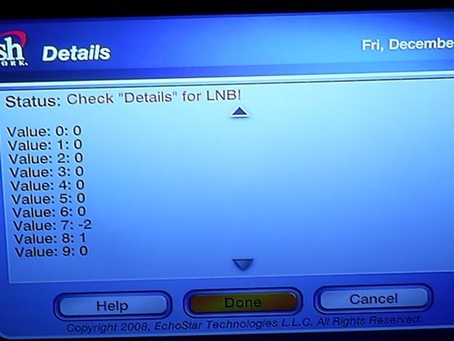

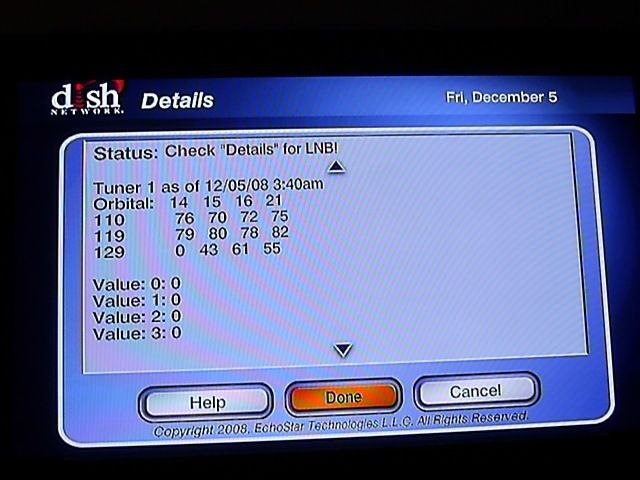

Here are the screen shots from the bedroom.

Yep I know. So if there really isn't a "true" drift to be causing my problems. Then what is causing the problem.

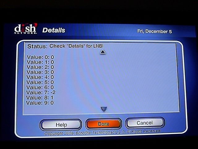

I'm little bothered with bold UP arrow of second pictures - that mean something up there; can you by pressing PgUp to see any the drift numbers ?
I arrowed down and snap a picture of everything. I just checked it and the photos show everything I can see. It won't let me advance up any further.
Forgot to mention they changed the LNB again today...I've done a restart of the receive to see if that help reset the receivers but that's still not helping the picture. It still cuts in and out.
Looks like Dish created new bug after adding the STBLite diag data :(, as usual for them.
Well I could suggest some of those Value# at bottom could be the drift value, but nobody know for sure.
