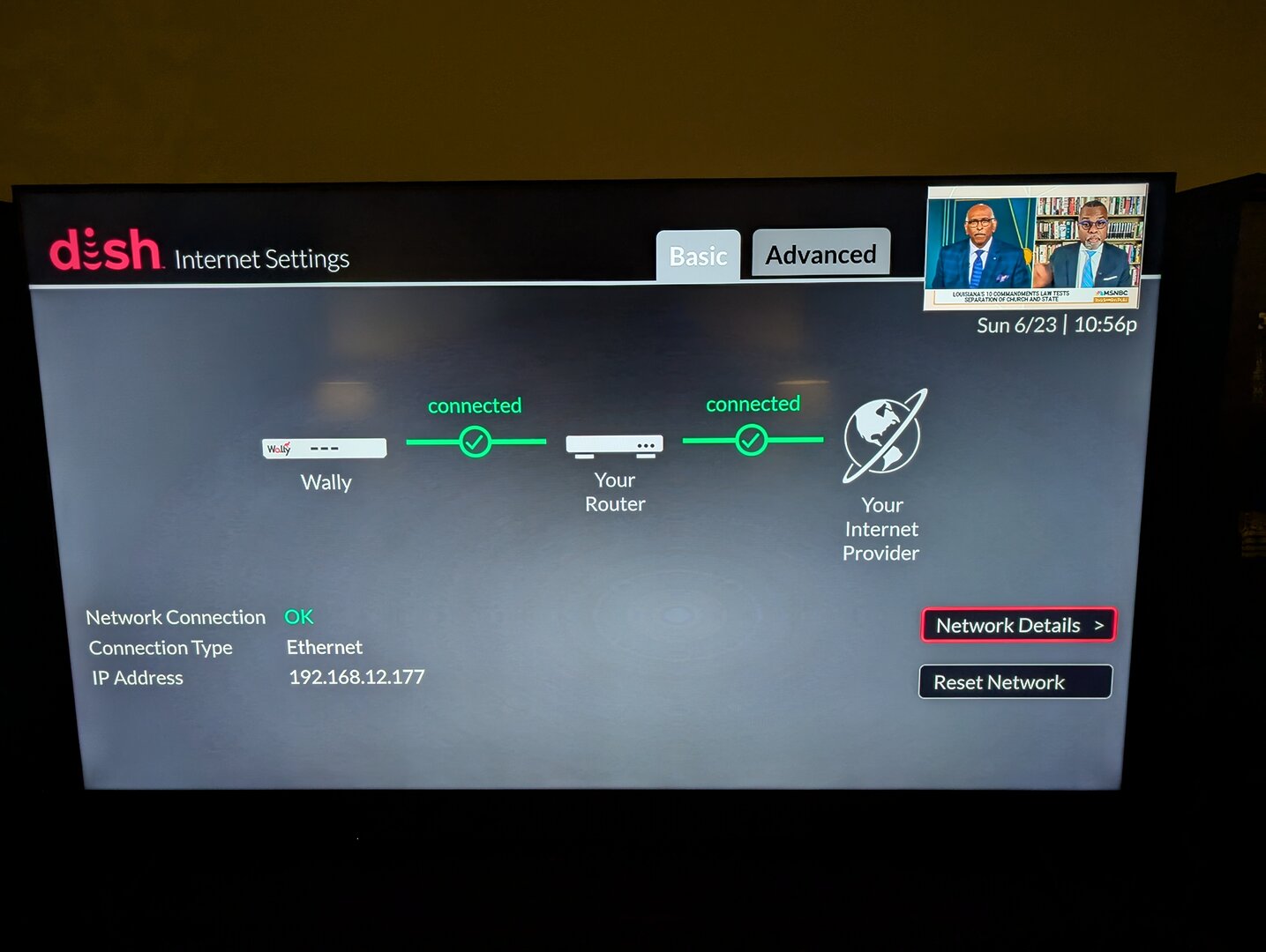

I cant find how to activate signal protector. I installed the wally usb wifi adapter and its connected to my wifi but I dont see where I can activate it. Help please. It's a WALLY receiver
No one here has an answer? Is it because i need to force an update or what? Please need the info.

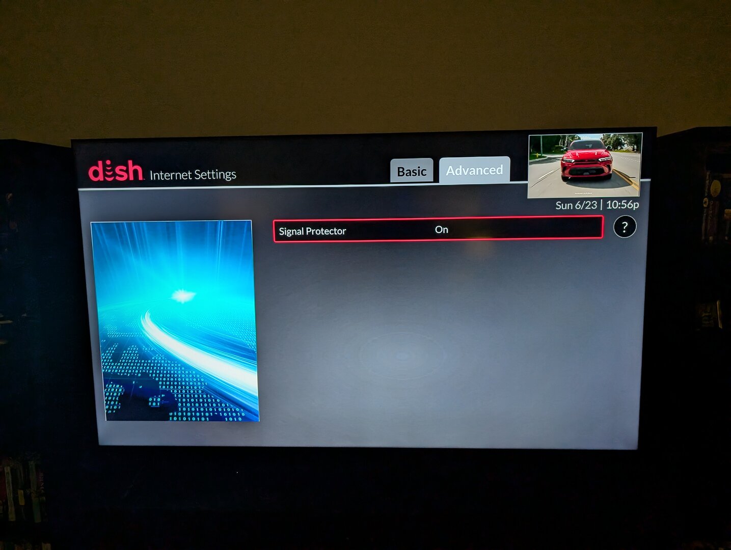

Try this, this is how it sets up on a Hopper. The basic software should be the same:
1) click the home key 3 times to bring up the diagnostics page.
2) scroll down to Network
3) select Internet settings
4) select the Advanced tab
5) turn on Signal Protector
