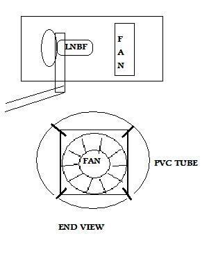

Concrete terrace; betcha it gets HOT! Suns rays directly upon the lNBF and are reflected off the concrete to the LNBF along with heating of the concrete itself.
A possible solution. 6 inch white PVC tube over the LNBF. 'Muffin' fan also in the tube. Keep the air flowing to cool the LNBF.
I have a feeling your 'symptom' may be a combination of more than just one of the above.
About the idea of PVC, do you have seen or do you have an image explaining a little bit better to cover the LNBF with PVC
Now about the 'Muffin' fan, what do you mean with that?

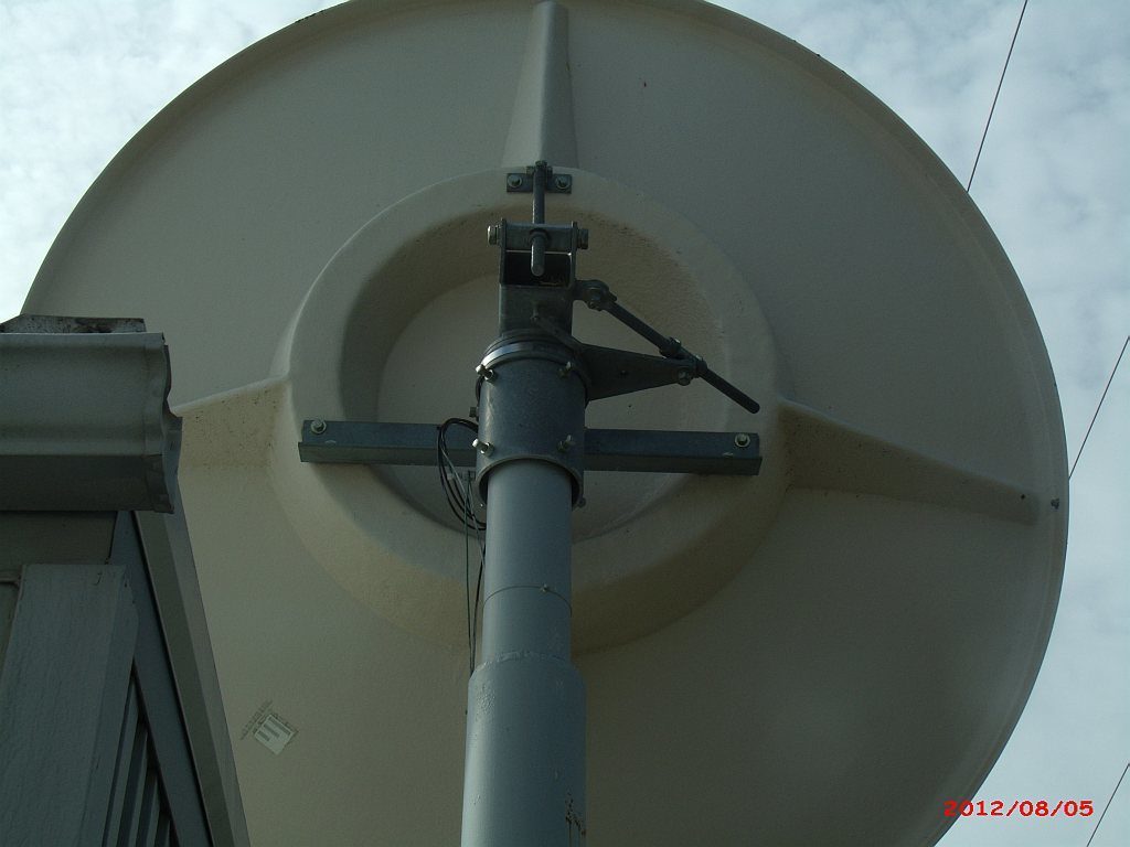

By the way a little bit off topic but you have an 2.4m offset dish right? what brand is it?
MUFFIN FANS
Pictures are worth a thousand words"
pvc_fan_cooler-jpg.97744
Cant remember the brand of the 2.4 meter at this time, and can't locate the thread with the pictures, nor figure out how to access previous uploads. I'll figure something out and get back. I DO remember that it IS heavy. Mount fits a 7 inch O.D. pipe(IIRR)
Thanks for the image, the only problem I see is where to power the FAN, I don't have any sort of electricity in where I have the satellites so I think I'm gonna first try something without the fan, something like an umbrella for the LNB.
About the 2.4m I hope you find your thread/pictures and who knows maybe we can make some business :D

Thanks for the image, the only problem I see is where to power the FAN, I don't have any sort of electricity in where I have the satellites :D
Mount a small solar cell with voltage regulator circuit near the dish and run wires to cooling fan. If designed properly unit will even turn itself on when sun rises and off when sun sets or could be set to run continuosly if needed. :)
