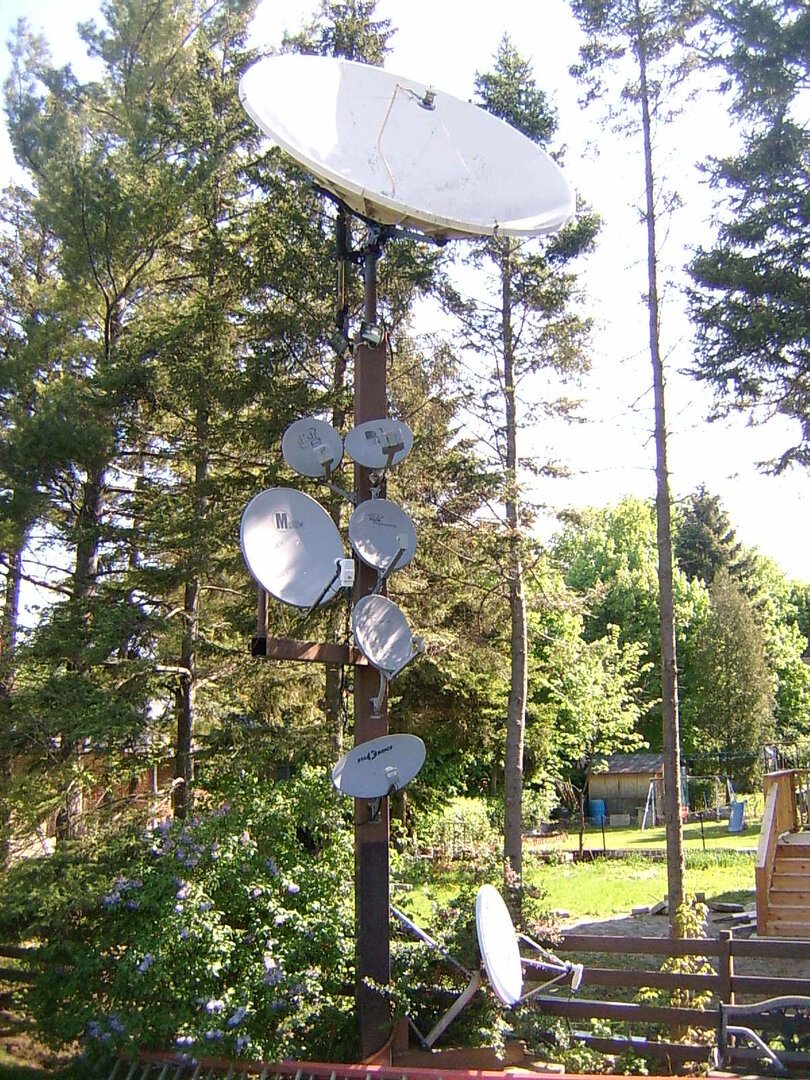

Hello,
I cannot get 4180 H on SES 1, 101 (or other H transponders)
. I get both polarities on other sats, but not SES1. On verticals I get signal strength of 91, and quality of 72. Even when I swap over to KU, ulta good signal. Just cannot figure it out. Any help would be greatly appreciated. Oh yeah, I put this dish up June 1985.

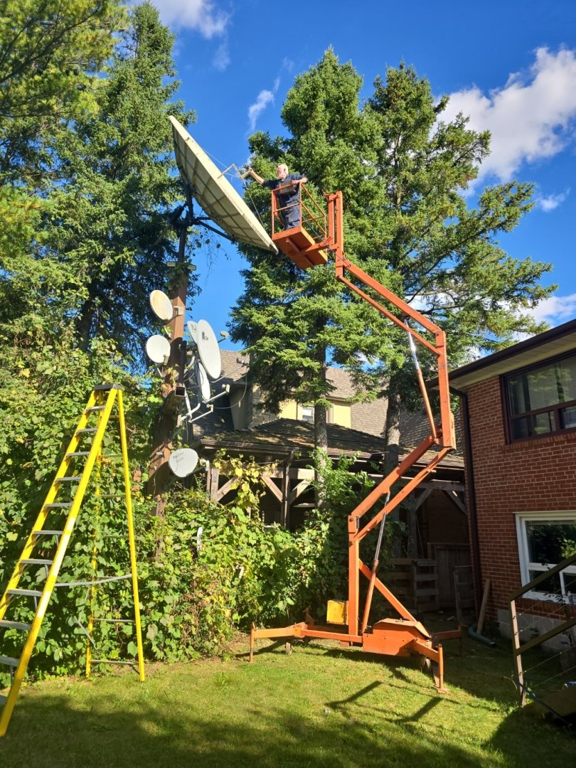

Thanks, I did several rescans, no luck. I was thinking 5G interference. I will put a spectrum analyzer on it today. But you make a good point, I may be off center. I had that issue with 87. I am too old to go up the ladder anymore, and am bringing home my man lift. The center of the dish is 36' off the ground. Before total loss of horizantals, I had screeching and pixelation and drop out of transponders on this satellite (101) only. That is why I am leaning toward 5G. Asked for a quote for a dual ortho 5g lnb, waiting to hear. Thanks again.

I got it close, but not perfect. Then I decided to do it properly. I swapped out the lnb for a Titanium 238. Recentered the lnb. Strangely, it would not get measured to centre, but was 2 inches off in the vertical. I measured the true focal distance and changed the coax cables. 91 signal and 74 quality right off the bat!! Never in 40 years has it been this good. I cannot reccomend the Titanium 238 enough.
