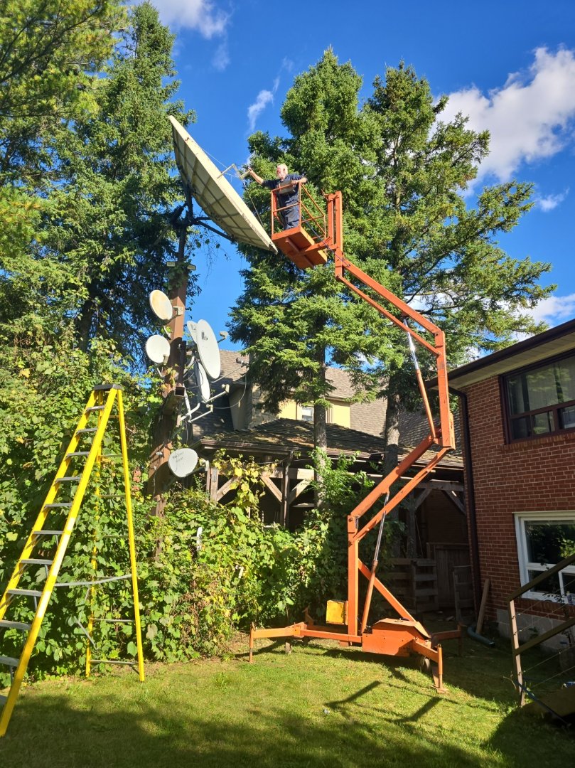

I used to tweak the dish by hanging a rope off it and pulling on it from 30 below. It worked and it hash't moved in over 30 years. The dish is 36 feet to the centre, 41 to the top. Never moves.
I used to tweak the dish by hanging a rope off it and pulling on it from 30 below. It worked and it hash't moved in over 30 years. The dish is 36 feet to the centre, 41 to the top. Never moves. I used to climb the 44 foot ladder on the ground, but once past 65, I said no more and use a cherry picker.

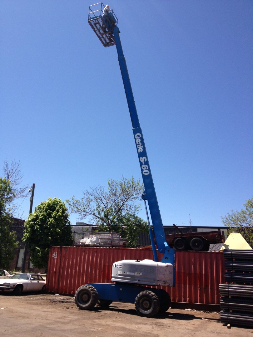

I wish I still had this one, but I sold it about 12 years ago. Besides, it would not fit between the houses, but I loved it.

Holy crap. Why mounted so high in the first place, is that the only way it could get LOS?

When I put it up, there was a monstrous tree that overhung 4 houses. It was simply huge and was two doors down and directly west. So this was the solution. Sure enough, three years later, they cut it down, it took them five days, working all day to get it down. Back in my twenties and thirties, I had no reservation about going up there. Before the trees beside it were trimmed, they covered all but the top. I would have people over for a bbq and be in the yard for an hour before they noticed it. Made me chuckle. Then the questions would start.
