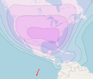

Shoot me a satellite that you get with different signal levels on H & V transponders.
Give me the frequencies and polarities. Where abouts do you live?
Can you switch to display decibels? If not, no biggie
  • Screenshot 2024-11-17 at 15-18-23 SatBeams - Satellite Coverage Maps - Sat Footprint Directv 1...png
I am in Toronto Ontario Canada. Upgrading from a BCE dual output? Before all transponders came in at 91% strength. Now some of them are fluctuating from 40% to 90%. But what has me stumped is 91% strength and 0% quality. 5G? Every other satellite works as it should.
Your 91% strength reading confirms that you are operating the system, but not really much more than that. If you have a similar reading on the other polarity, but have a fair to good Quality reading, that is where you should be adjusting and monitoring. Quality reading often differs between H and V, so peak one of them for highest reading and then go to the opposite polarity on a transponder assigned to it.
Balance back and forth until both have something more. Fine tune dish up and down as well as left and right to get highest reading on your strongest side. Once there, go back to optimizing each polarity separately until they are fairly balanced in level. Good luck!

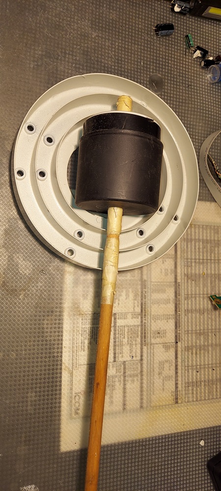

Before everyone gripes. The photo attached is the jig I use. Nuttin' fancy. 2 paint can tops that telescope into each other with a wrap or so of tape to take up the slack. And the dimples in the center to poke a few holes and stick a dowel in. You could use a measured and cut fiberglass driveway marker stick. I used wood. And. It's RF transparent.
When I setup a big dish. Paramount. Aim the lnb at the dead knutz center of the dish. Make absolutely sure that the dowel does not protrude into the lnb anywhere close to the probes inside.
Everything works around getting as best of a signal with the lnb aimed at the dish center. Do what is needed to your aim to get the best possible signal. Even if you have to move the lnb around a touch to get the first hint of a signal to let you know you're close to an aim. Tweak the dish position until the lnb is aimed as close to dead center.
Mike says it! You tune to a horizontal (or vertical) transponder. Get get your signal strong as you can.
In/out a bit with the lnb. Left/right on the skew. As strong of a signal as you can get. Snug the 3 bolts a little. Do not crush the lnb waveguide throat. Watch your signal as you snug it up. It will waver. Do what you need to do to keep the signal high. Sharpie the lnb and scalar (super fine point) so you have a reference mark.
If the lnb is sloppy in the fixture. Try a few wraps of aluminum hvac duct tape. Helps shore it up and the screws something to dig into.
Switch to the opposite polarity on a transponder. How's your signal? Lightly loosen a holder bolt and without moving the lnb in or out. Turn it in the holder/scalar left ot right and see if your signal increases. Peak it. Snug it down again.
Pay attention to your sharpie mark. You only want to turn the lnb. And again. Watch the signal when you snug the perimeter bolts/screws. BTW. I file the ends of the stainless screws on mine flat. Less tendency to walk he waveguide.
Switch back to the other transponder (opposite polarity). Make a tik mark with the marker where it currently is.
Then lightly loosen the lnb and see if turning it left/right a tiny bit increases the signal.

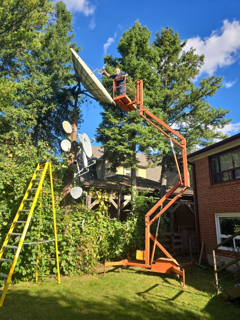

OK. Now I think I have confirmed the answer. Everything runs perfect on 4180 H, all day long. No flucuations, pixelation, freezes, etc. UNTIL around 9 PM. Then it starts, everthing you would not want. All other V and H are affected to a much less degree. Sats on either side perfect. It lasts until after midnight. THEN perfect again. No wind, rain or snow. No movement on the dish. I did not get a chance to put my spectrum analyzer on it last night, but I will try for tonight. I think there is definately some outside terresterial interference making the signal lose lock. During all this, the P and Q do not change, steady at 91 and 72. But black screen or screetching. As I mentioned earlier, there is a private airport (manufacturers facility) about 2 miles away. At night I can hear them run up the jets. I think that is when they turn on the radar that is causing the problem. There is just too much regularity (time wise ) to the problem for it to be a dish issue. I had this with my previous LNBF that I changed out from last month. Same pattern. Same issue with 82 and 91 about 20 years ago. Going to a narrow beam dish solved it. I have to step back and accept this, or I will lose what is left of my mind. Also, now that I am just about 70, for the last month or so, I am no longer comfortable being up there, particularily when things are moving. Once, (30 years ago) while up on the ladder changing out the servo motor, I was up there for about an hour. I was deep in the dish and could not see outside of it. When I was done, not remembering that I was up on the ladder, I took one foot off the ladder and went to step away. I hope my recent repairs hold, I am thinking my days off the ground are coming to an end.
