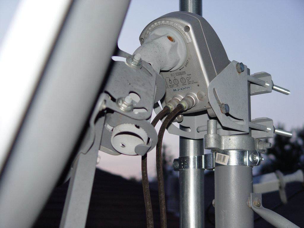

can you post a picture of your setup? Sometimes it helps us all help you.

Your dish certainly should not be looking at the ground at true south. In New Orleans, with the same motor, mine looks like its looking at the horizon when I'm aimed at my farthest west satellite (148w). Sounds like something may not be assembled correctly. Can you post pictures? The SG-2100 should be installed with the shaft facing down.
