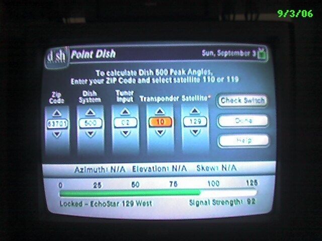

I just took this picture at my house on a Dish 1000+ with my cell phone so it's a little small, but if you click on it and open it bigger you can see i'm getting 92 on the 129. I'll admit there are still a few transponders that are in the low 80's but most are high 80's/low 90's
Here is a breakdown of what I am getting on 129
Transponder Signal
1 84
2 86
3 85
4 84
5 ---
6 87
7 ---
8 86
9 88
10 92
11 96
12 91
13 90
14 88
15 ---
16 92
17 ---
18 85
19 82
20 85
21 ---
22 84
23 82
24 88
27 ---
30 87
31 86
