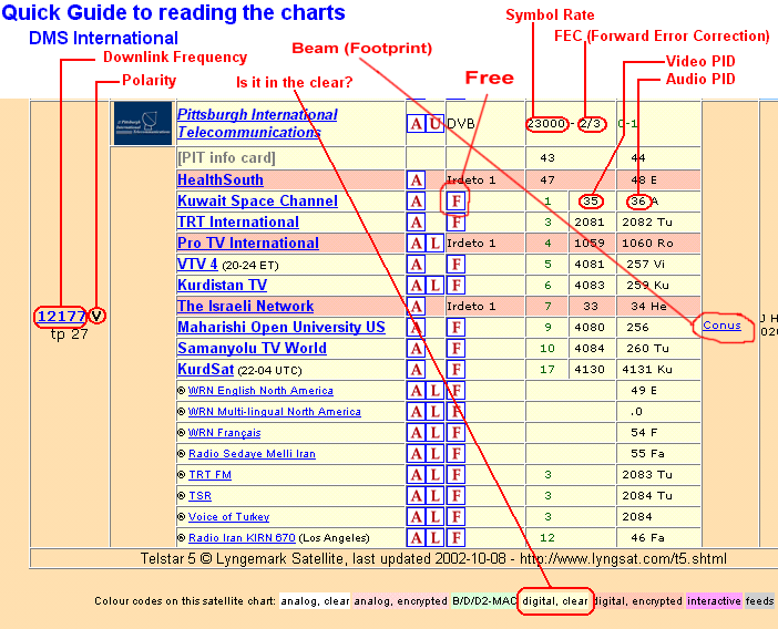

The below should help you read the Lyngsat charts!
C-Band has 4 digit Freq. (6' dish)
Ku-Band has a 5 digit Freq. (30" dish)
