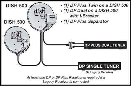

OK, I think I have gathered all the parts suggested. I hope I have the correct stuff for an install this week, or weekend.
So, I have two new to me LNBs. The DPP twin has 2 coax, labled 1,2 and LNB-in. The one for the 61.5 sat has two coax connections. The separator has three connectors, 'input', sat in 1 and sat in 2.
The separator goes on the back of the 721 I would assume, or maybe not. Hmm.
OK does anyone have a diagram or a good description of what connects where?
This should work for you:
Thanks, I guess my SW21s go to the trash or on ebay from the look of the drawing. Also, it seems the separator goes to the back of the receiver, not on the roof. Cool. It also seems like the DP Dual output choice does not matter.
OK, One last question. Really, I promise
That picture shows both dishes being "dish 500". My second dish is a dish 300 pointing to 61.5 only. Is that a typo on the drawing or doesn't it matter? I would assume it doesn't matter because the DP Dual only sees one sat, correct?
I take back what I said, the existing 61.5 dish has "dish 500" printed on it and it has a 'Y' on the arm with one LNB attached, I assume I will just swap one LNB for another and use either coax connection. Not enough light to do tonight and I don't want to be offline for 24 this eve! Will try tomorrow afternoon.
