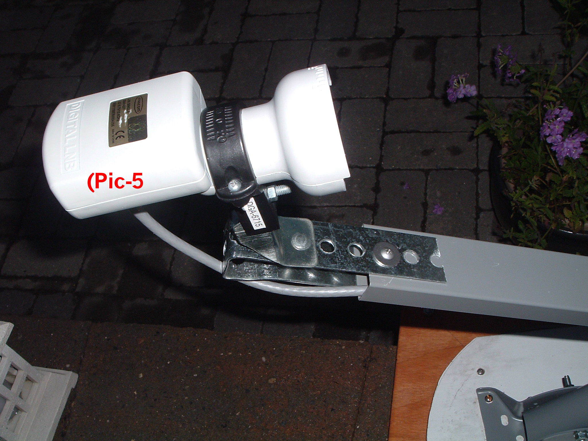

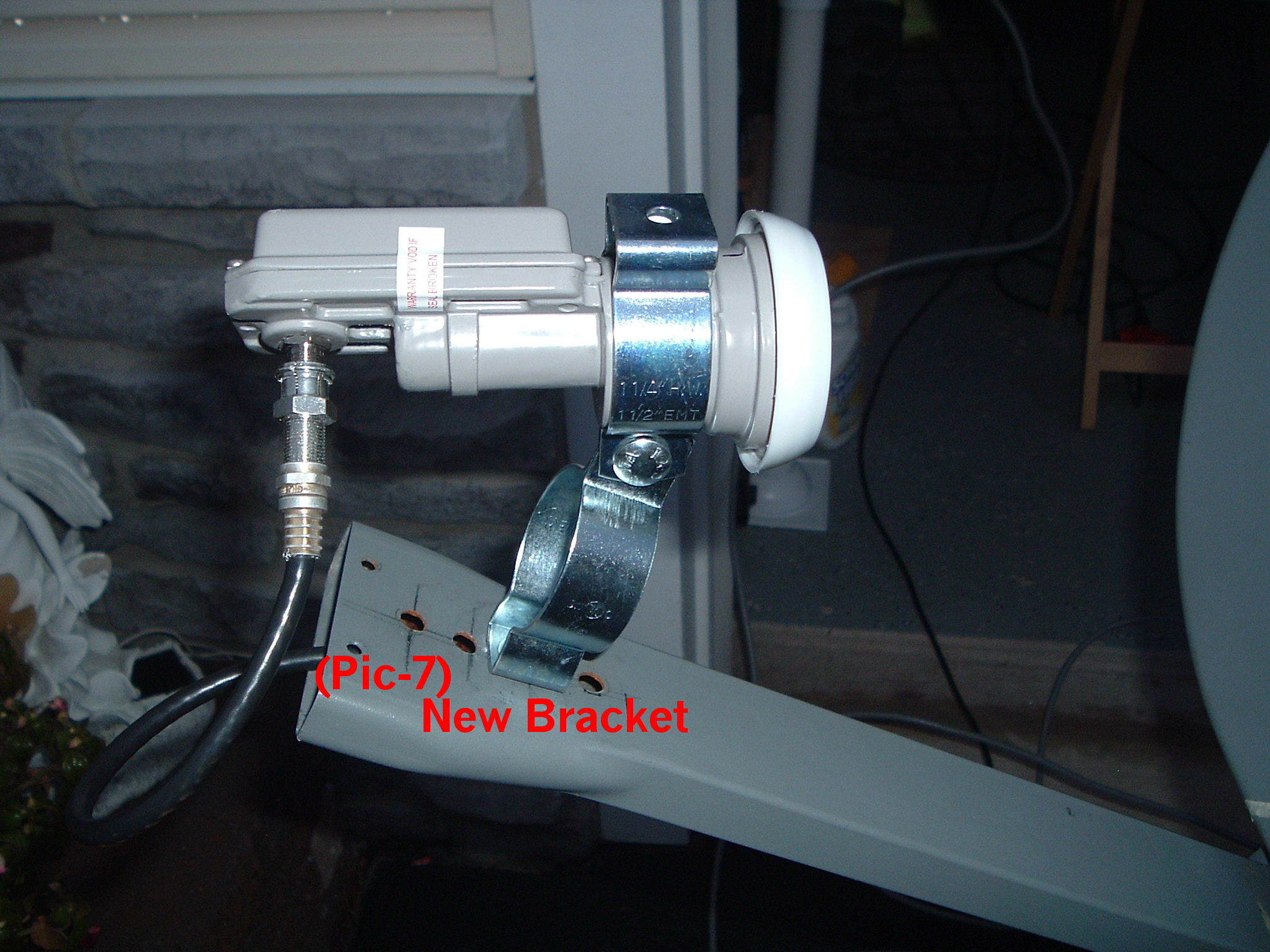

Or you can try and make your own with electric conduit holders

$2 @ hardware store:
I'm with Mike. Here's a similar bracket I used to mount an LNB at the correct height & angle.
Exact same problem: rectangular-based LNB was replaced by an LNB needing to be mounted by its neck.
Read the adjacent posts in that thread for more construction and alignment info.
Since you have the original to compare to, it should be no problem.
