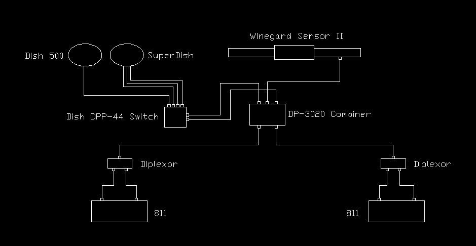

This is how I hooked up my two 811's with the 3020 combiner. My 3020 looks just like yours also. Make sure that the right connections are going to the right ports on the 3020.
I’ve got the same setup, connected just like your diagram (plus a 311 that’s connected directly to the switch). I really hope the DP-3020 is bad because if not, who knows what the problem could be. My diplexers are Radio Shack and rated at 2150.
