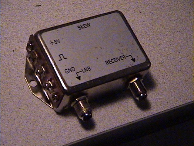

Well, no... my servo motor works fine. Here's a picture of the box that I had that was working great. It connects to the receiver and to the servo motor and it turn the servo based on whether it receives a 14V or an 18V signal.
Pretty good idea . If you find a source , please PM me .

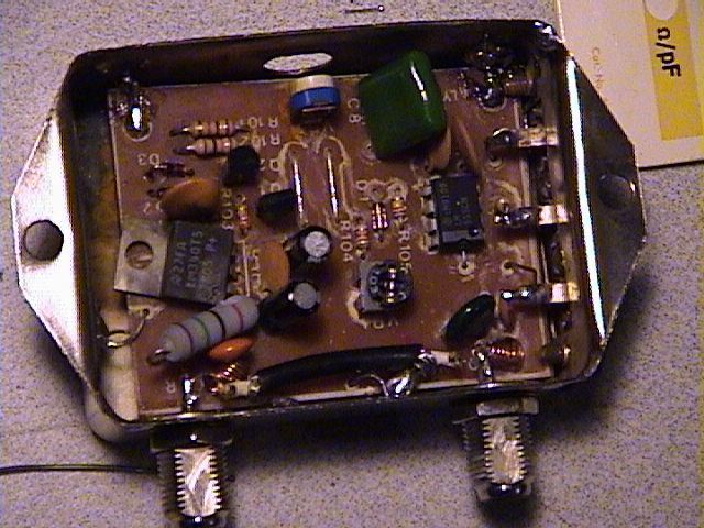

If I send pictures and answer some questions, is there anyone who thinks they'd be able to help me figure out what's wrong with mine? It's not that complicated of a circuit, maybe 20 parts in all (a 555 timer, 7805, some resistors, diodes, and caps).
OK, here goes. Here's a couple of pictures. I'm right in the middle of studying for an organic chem test, so I apologize for not drawing out a crude schematic, but I don't have time right now. I'll try to do that in the next couple of days.
Anyway, like I said before, the circuit was sitting in a bag of rusty water, so a lot of the parts rusted away. I replaced 2 of the diodes, 4 or 5 of the capacitors, and the 2 transistors. One part that I wasn't sure about was a resistor. One of the bands had burned off, so I couldn't read the specs. It was a large 3-5 watt resistor, somewhere between 10 and 19 ohms. So, I replaced it with a 15 ohm resistor. Any thoughts about what the correct value might be?
The actual pcb was somewhat damaged, so every time I solder to it, I'm afraid that I'm damaging the tracks. It's really hard to tell what is supposed to connect to what.
Anyway, after I replaced some of the parts, put the circuit back together, and connected it to a receiver, the +5 and GND terminals have the correct voltage coming out. The circuit will turn the servo motor if I use a screwdriver on the skew adjustment screw. But when I switch between H and V channels, nothing happens.

As I'm drawing chemical formulas, these thoughts keep popping in my head, so I'll spit them out real quick. I'm obviously not an electronic circuits expert, but I came to a few conclusions. Please let me know if I'm wrong about anything.
I get a good +5V output, so I assumed that the 7805 was working and I didn't replace it. Since the servo can be turned with the adjustment screw, I assumed the 555 chip was working by sending out a pulse, so I didn't replace it either. I replaced the only 2 transistors, but now I don't know what to do... :(
