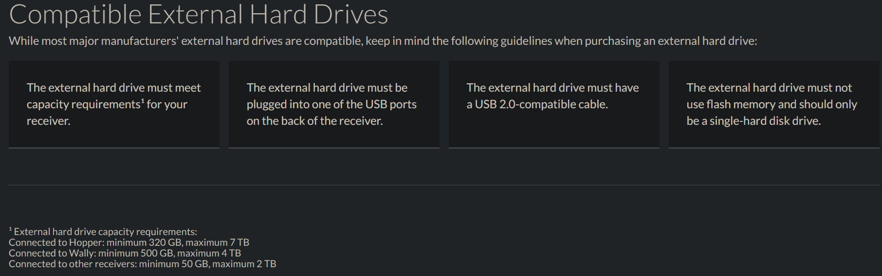

Can the Hopper 3 (H3) really use all the capacity of a 7TB drive since I thought 2TB was the largest it would allow usable per drive?
The trick would be to actually find a 7TB drive, since the standard sizes are 6TB and 8TB. People have had mixed results. Trying a single 8TB drive, it was not recognized at all. Trying a 6TB drive, one member was successfully able to add a 2TB drive, for a total of 8TB. However, another member with a 6TB drive was not able to get the Hopper 3 to recognize a 1.5 TB drive. In any event, at least 6TB will actually work. It is when you try to approach or exceed the 7TB "limit" where things start to get weird.
Yup, and I can report that the 6+2 combination still works in U939. Probably shouldn't talk too loud or someone at Dish may just "fix" it! :(
But, it's is a combination of the right drives, and the right hub (non-powered) and plugged in a specific order. I have 3 drives, 1 6TB and 2 2TB's. To use the other 2TB, I just unplug the current 2TB drive, get the disconnect message, plug in the other 2TB drive and wait for it to be recognized. Luckily one of the 2TB drives is just for my wife's Christmas movies so hopefully I won't be swapping drives in and out so often.
I thought Seagate did make a 7TB drive called the Ironwolf assuming one is able to get their hands on it. I had a external HDD dock that worked on the Hopper 1 but was not recognized with the Hopper 3. Now the other question is, is it true that one can do 21TB max over 3 devices as mentioned here:
Right now, I have 1 drive that is a 3.5" Western Digital 2TB using a USB 2.0 to SATA adapter cable, 2 x USB 3.0 2.5" Ultra external Western Digital drives all connected to a USB 3.0 hub. Has anyone tried more than 3 drives via a USB hub?
