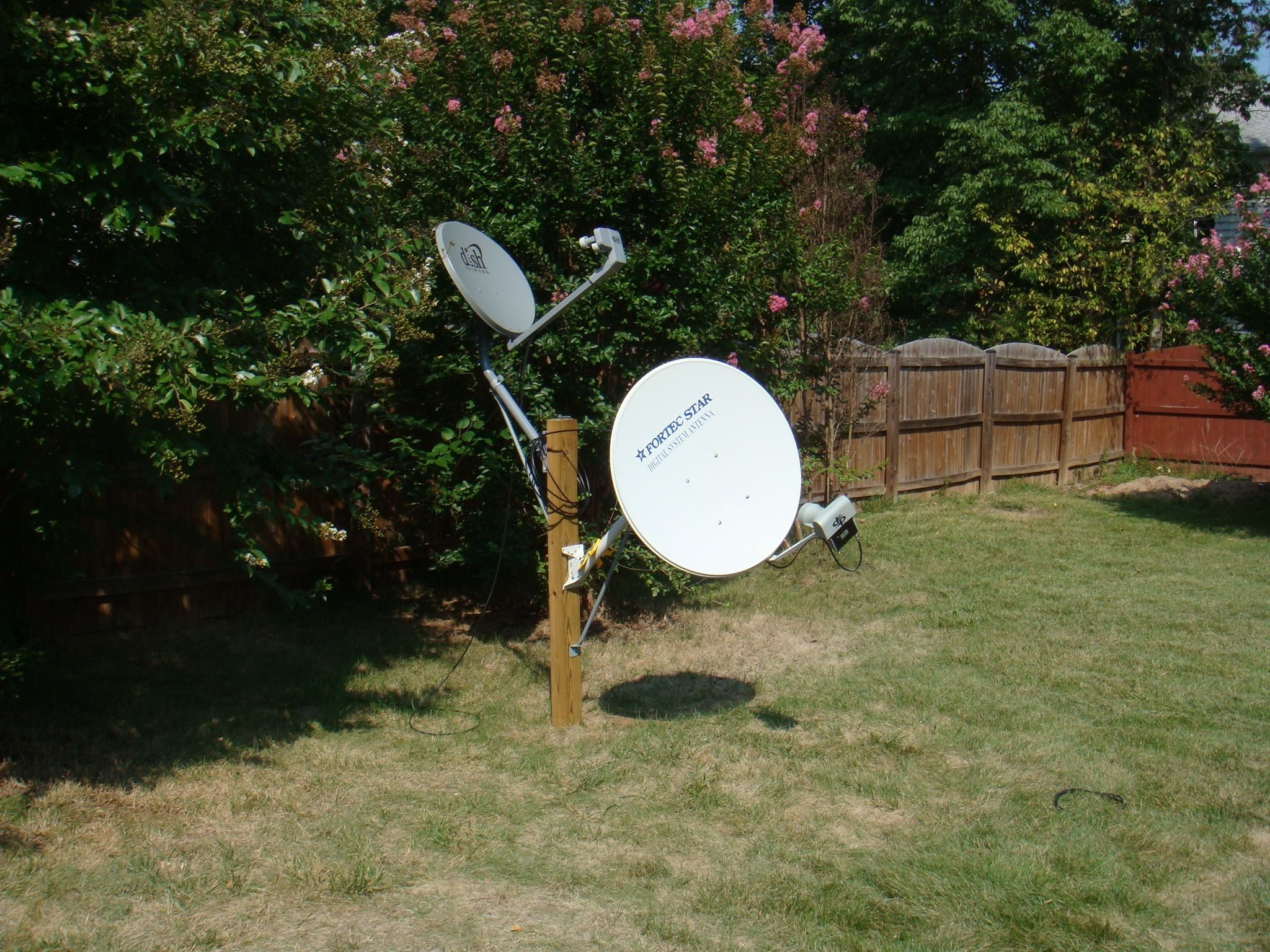

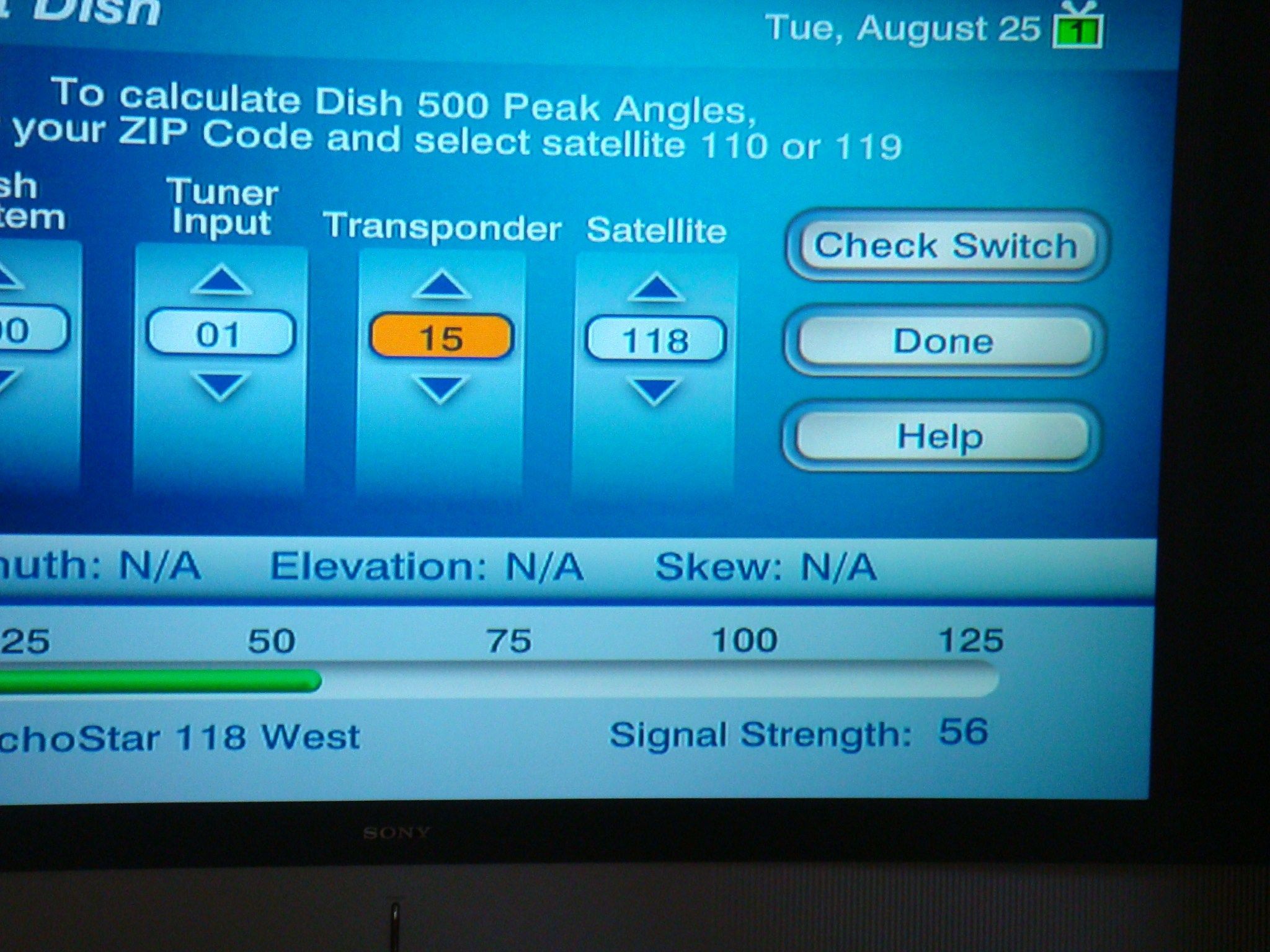

Here are the results so far. The signal seems a little jumpy, between 51 and 61. I plan on removing the motor from the Fortec to make it a little more stable. Does anyone think I can do better on the signal with this setup? Also, am I able to "move" using online chat with Dish instead of calling?
