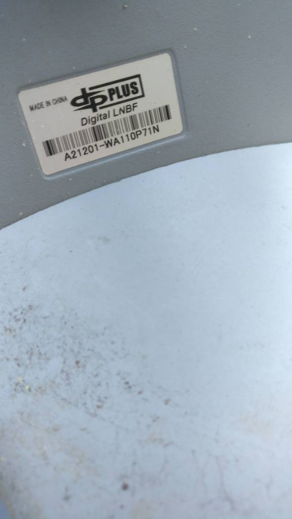

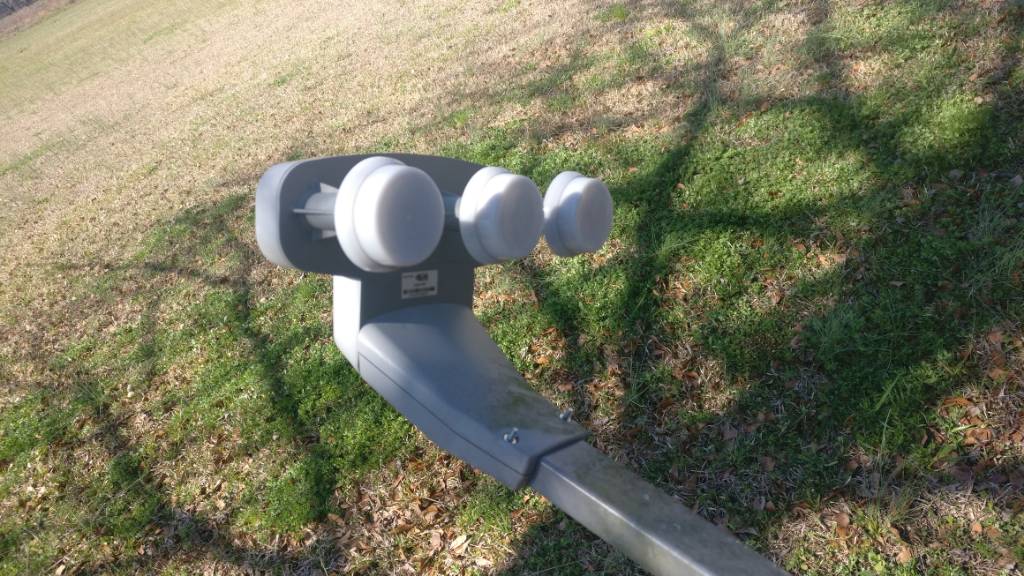

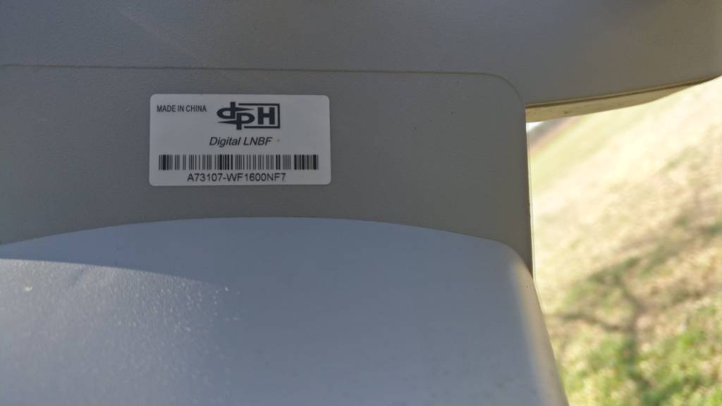

Will this LNB allow me hook up two Wally's? If so will I need anything else or just a coax from each Wally to a port on the LNB?

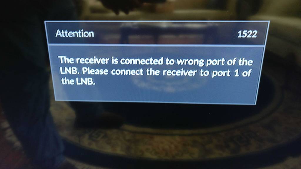

Ok... So it doesn't work. The receiver plugged into port 1 makes it to the activation screen but the receiver on port two does not. The second receiver has the message that you see in the attached picture. I believe that this is the wrong LNB for two wallys.

Ok... So it doesn't work. The receiver plugged into port 1 makes it to the activation screen but the receiver on port two does not. The second receiver has the message that you see in the attached picture. I believe that this is the wrong LNB for two wallys.View attachment 138137

I'm sorry I didn't realize that was a hybrid LNB in your previous picture. Apparently Wally's won't work with the separate ports of a Hybrid LNB so you either have to use a DishProPlus LNB for 2 lines to the LNB or a Dish Channel Stack Splitter so both Wally's can be use port #1.
