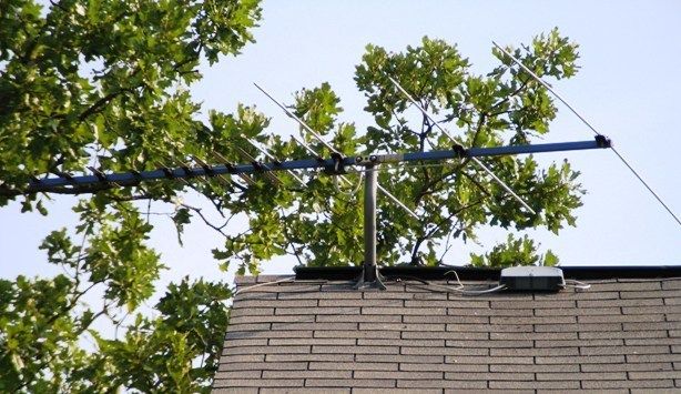

I've installed hundreds of OTA antennas over the past 35 years. My favorite is the Winegard HD7210 Ghostkiller. It's available at Solid Signal | DIRECTV® Systems, HDTV Antennas, DISH Network, satellite equipment and home entertainment supplies & accessories
I am in the Greenville Spartanburg, South Carolina area. I get four sets of PBS HD and all of the networks. Analog is crystal clear and better than cable or satellite, of which I install both Dish and DirecT.
My favorite amp is the Channel Master Model 3041 DSB amplifer, which can be had for under $30 delivered on eBay.
The nice thing about the Ghostkiller is that it has only 3 inches of vertical height. A standard satellite "J" pole makes an ideal mount. Unlike some uhf only yagi's the Ghostkiller is mechanically balanced and puts very strain on the mounting pole.
