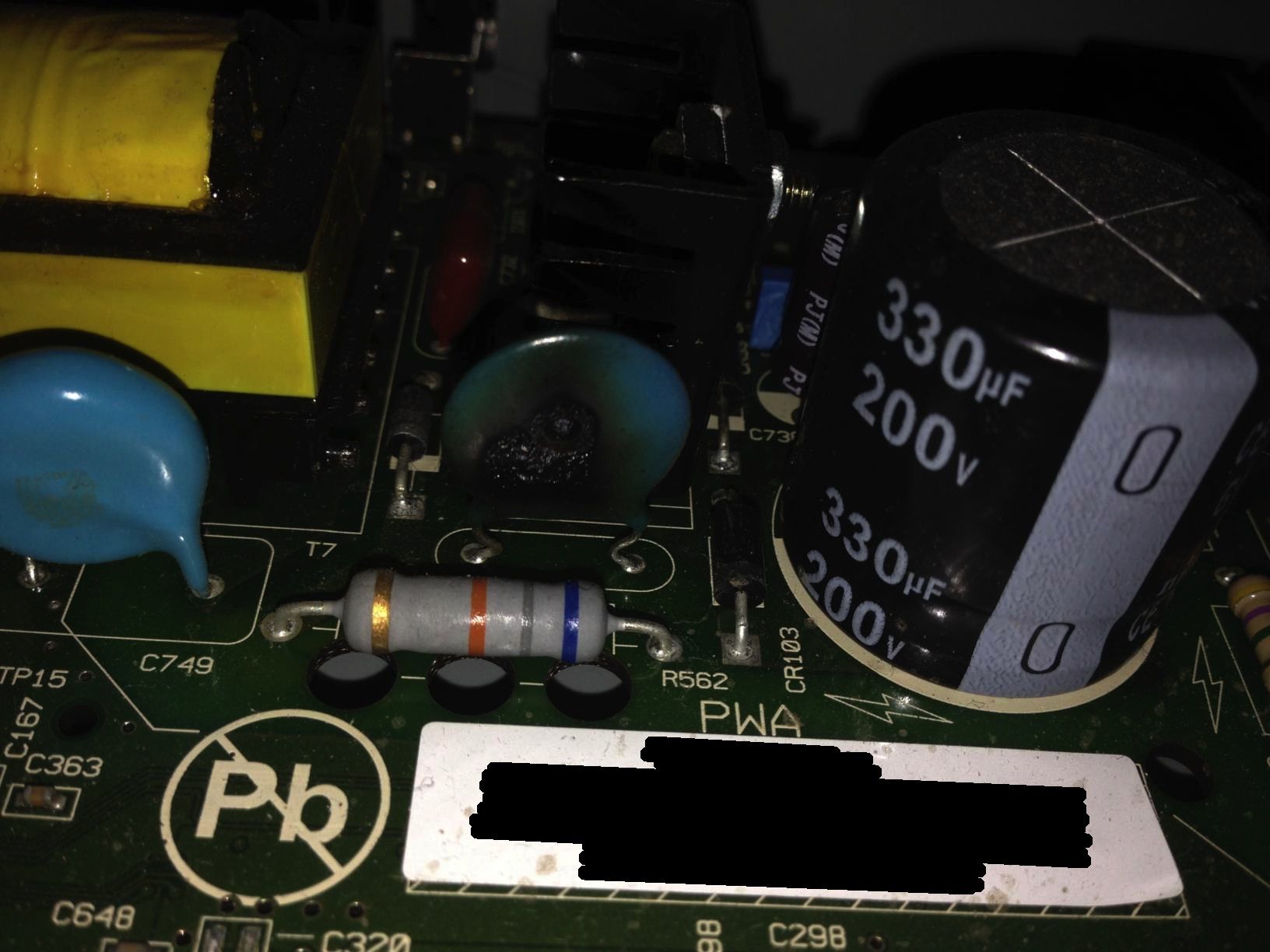

A capacitor burned out in one of my two tuners. I would like to buy a DEAD vip211k for parts so I can fix mine. It's extremely obvious which part is burnt out and I have a soldering iron so I can fix it if I can just get a replacement part. I figure buying a dead one will ensure I get the exact right part. I would like to fix it so that my recordings on my external EHD will play once it's fixed.

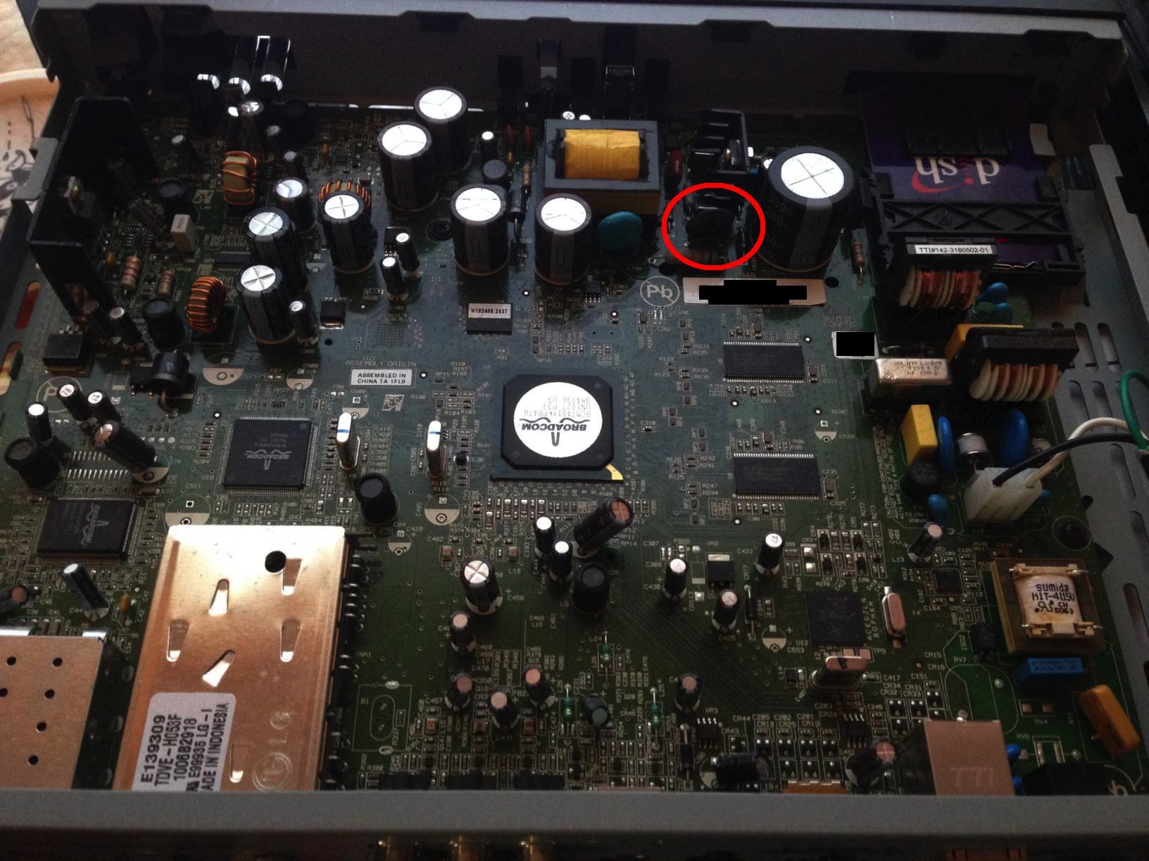

The part that burnt is VERY burnt so I don't think I'll be able to get a number off of it. That means I'm going to have to open my other tuner and take a picture of the undamaged part in it.

I dread digging the other tuner out of the bookcase downstairs, it's a real pain to get to it. But I have to so I can get pictures of the part that burned out.

Usually if a disc cap blows something else in the circuit has went bad, so be mindful of that.

The working tuner is up in a bookcase and it's a genuine pain to get to. I never really considered taking it back out. I guess I'll get a ladder and give it a go in the wee hours when nothing is on.

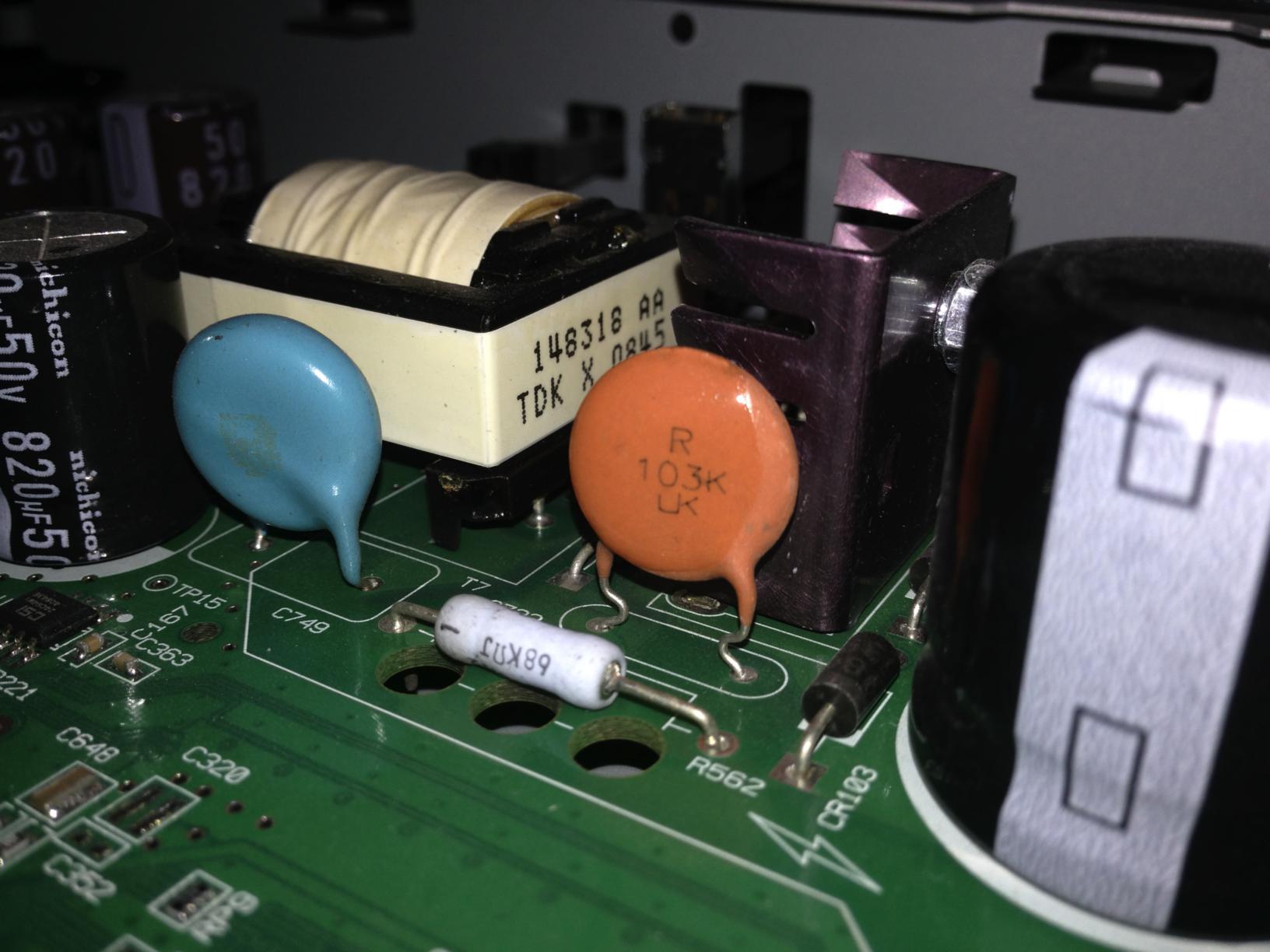

I opened my other tuner that's still working fine and took a picture of the same part. There is a number printed on the main boards "C733".
The part that burned out is powder blue colored and the one in the other tuner is kind of a leather tan color.
The one that's burnt out is so badly burnt that it's impossible to read anything off of either side, it's burnt through and through.
I don't know what the numbers and symbols printed on the good one mean. It looks like it says R then under that it looks like 103 K and under that, I'm not sure what that is, It's either an L and a K joined together or a U and a K. Maybe. No clue.

You may find it isn't a capacitor, it could be a Metal-Oxide Varistor (MOV). They are used to protect circuits from over-voltage. Edit: I just read your post with the "C733" label and picture of the good unit from your other ViP211K. Sounds like a cap to me. The rating is probably on the other side. The side you photographed is probably manufacturing marks.
Another site I've used to find hard-to-find parts is www.mouser.com (more of a professional-level site)
She has the correct info to get a replacement cap. The 103k translates to a uf value like wa6rht indicates. Just make sure the replacement is rated for 50V.
I still need a working vip211k. I replaced that burnt part, I was EXTREMELY CAREFUL in every step not to break or damage anything else, I am 100% confident that I did everything right.
BUT, something else is toast because when I plugged it in it just makes a chirping noise. It doesn't power up, it just chirps. So it's fried and I need a replacement.
