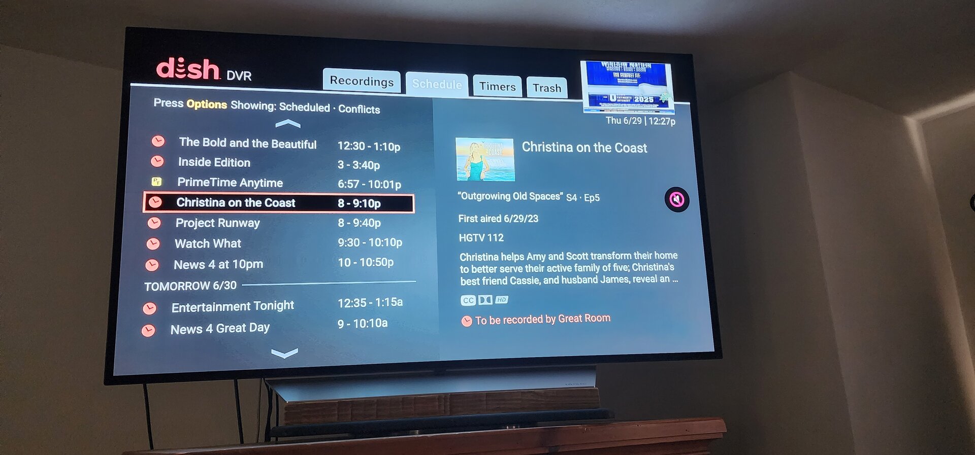

No. I have The Young & The Restless timer set to "New & Reruns" for both Hoppers to make sure it fires off. I mostly see the issue for the satellite channels. In fact, I have an example for you. On the HGTV channel 112 today at 9 PM eastern (8 PM central), Christina on the Coast is a new season program according to the TitanTV listing. Hopper says S4 E5 first aired 9/29/23. Hopper timer was not set to fire, so I restored it. You can bet that it will be a new program and the Hopper is incorrect.
