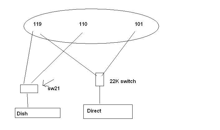

If the OP didnt have HD it can be done but you would need a Legacy setup with Dual LNB's as long as you don't have a bunch of receivers. Lets say it was one each.
Take a Dish500 and add a LNB on the side for 101. Now you would have 3 dual LNB's. Take one line from the 101 LNB and one from the 119 combine with a 22k switch and voila...DirecTV package (110 on D has only HD).
Take the line from 110 and the other line from 119 with a SW21 to DIsh...voila. Dish package
If you have more than one receiver per system you would need multiswitches but its still doable.
really crappy drawing attached
He could also add a D1000 or D1000.2 with a W bracket and add Legacy Dual LNBs for 101, 110 and 119 if he wanted but like Iceberg said 110 for D* only has HD. So all you'll need is two Legacy Dual LNBs and either dish with a W bracket (very important).
Another possibility is to have 101 from D* and 110 from E* with a D500 and add a second D500 for 119 and 129 for E*. The LNB for 101 MUST be Legacy though.
