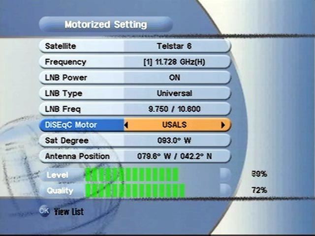

Did you leave the motor and dish assembly pointed at TS when you moved to T5? If so you may be able to track the arc. To use USALS Go to "Main Menu" and select "Motorized Settings". You'll see the screen I have attached. Select the satellite and LNB type and turn power on. Also make sure to select a "live" transponder. Enter your "Antenna Position" (lon and lat) if you have not done so. After you exit and save it will take you to the sat. If you are on the bird you should see a good signal. You can go back in and use "1.2" to nudge if needed. If nothing is working you are probably still not tracking the arc correctly.

You are right, AMC 9 would be your TS-you should probably re-aim for that. To add a satellite, first go into "Dish Setting" from the main menu. Use the left arrow key to move until a blank spot appears. Set your LNB type and power. Now hit the red button on your remote and rename it to AMC 9. Save and exit to the main menu. Now go into "Motorized Setting" and change "Sat Degree" to 83 W and "Diseqc Motor" to USALS. exit to the main menu. Now hit "Manual Scan" and then hit the green button to make a new transponder. For the frequency try 12020V SR 30000. It is encrypted but should give a signal you can tune to.
