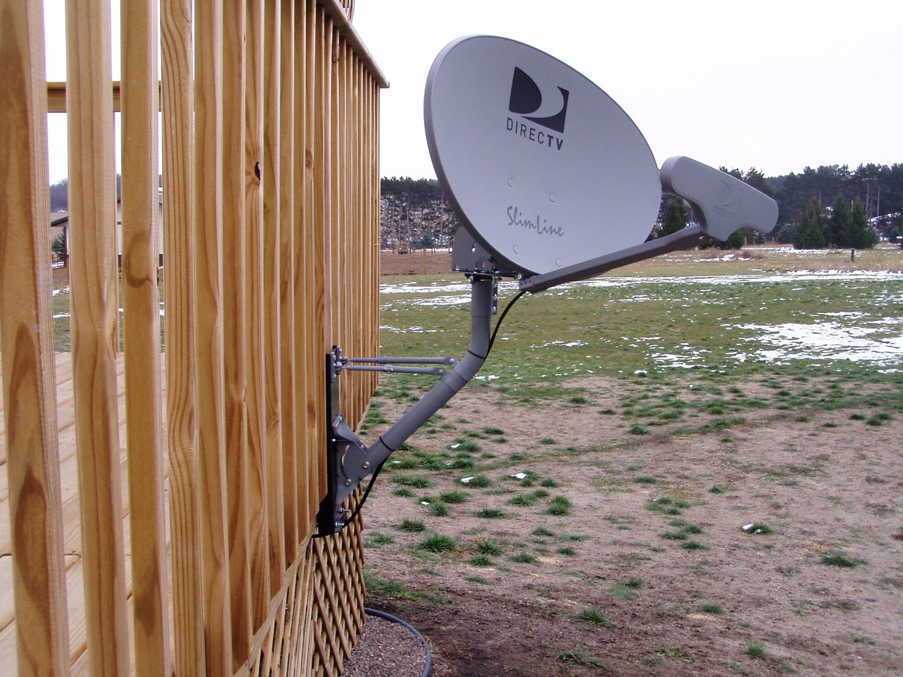

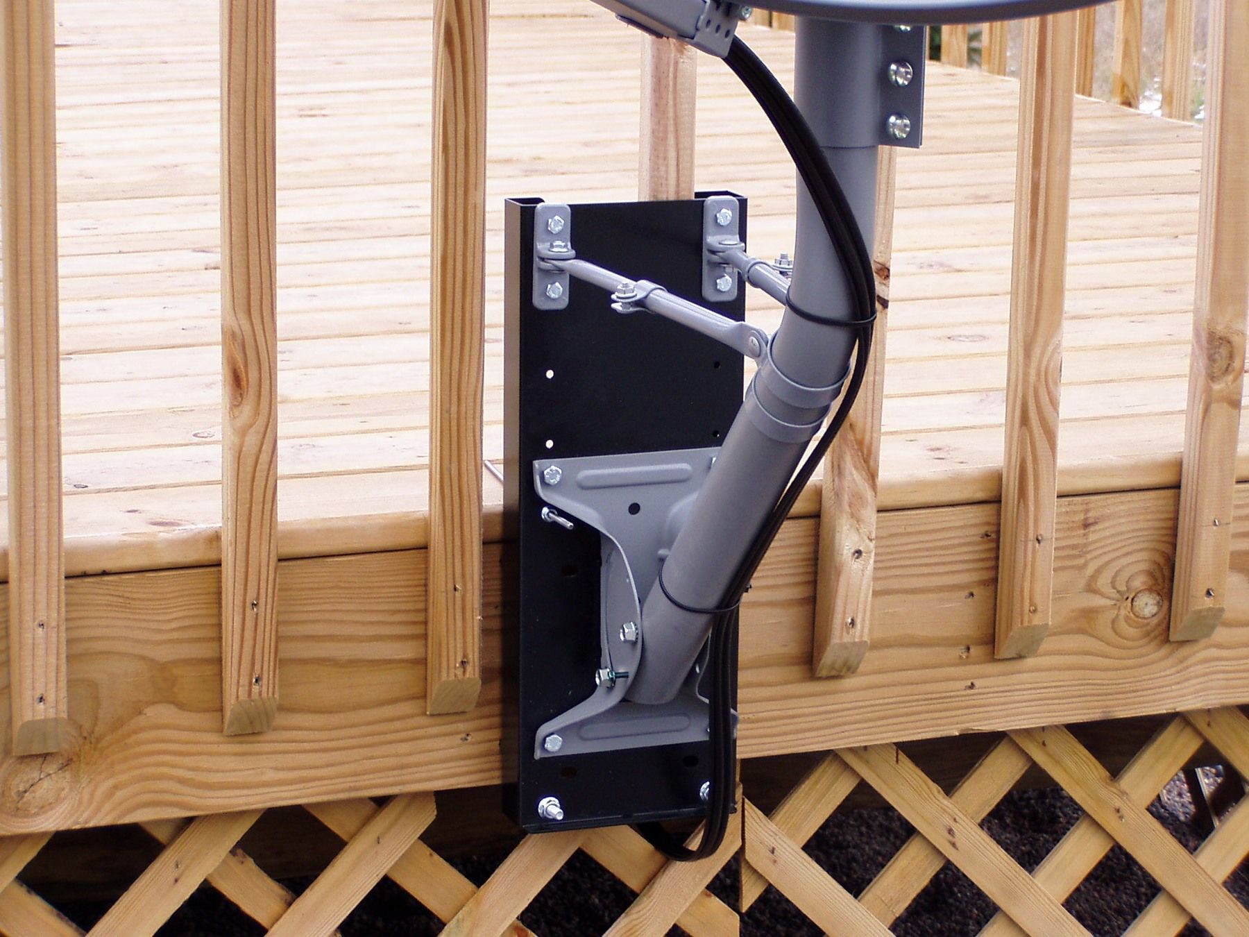

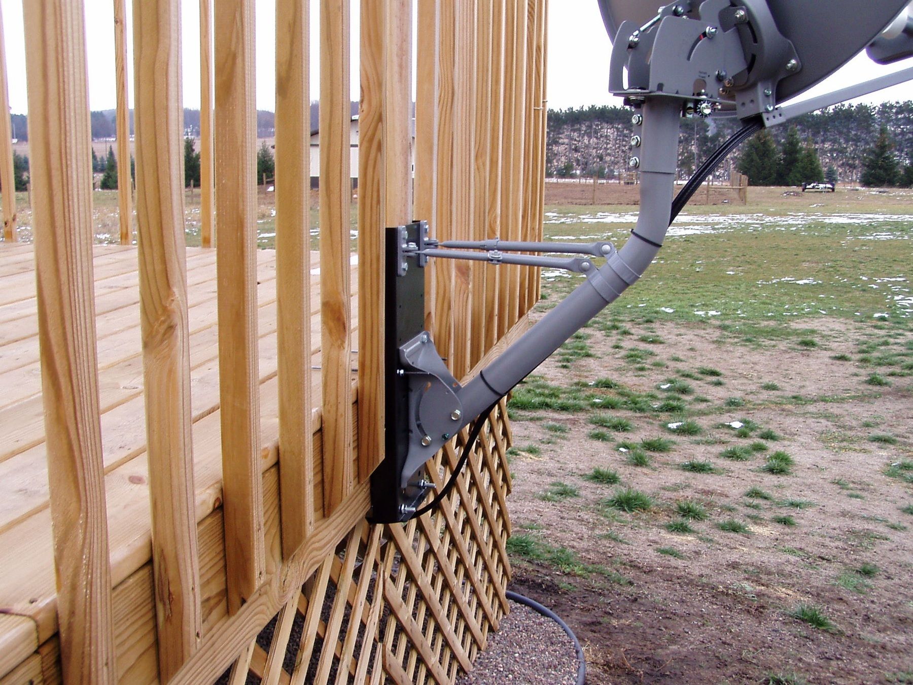

commdeck
We will be offering a new mount called DeckLock that clamps to a 8" -10" or 12" rimjoist on any style of wood deck material. This is a good product for landlord issues on rental properties as there are no lag bolts or screws used for the installation.
Like Commdeck and Retrodeck, the Decklock is designed and engineered to accept DirecTV, Echostar and WildBlue dishes. (both large and small)
