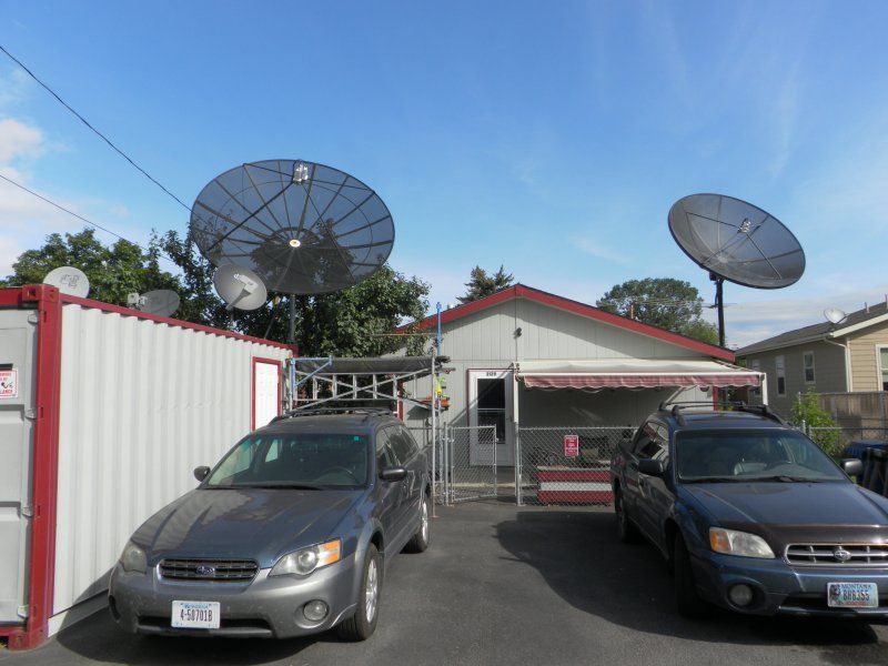

I use a Bullseye II feed and four Norsat LNBs on two 10' dishes, one for me and one for the wife ;)
You should know going in that the combo C/Ku LNBFs are somewhat of a compromise (maybe due to the different focal points in the feed tube?) but that being said, if it says Titanium on it it's gonna be good stuff.
