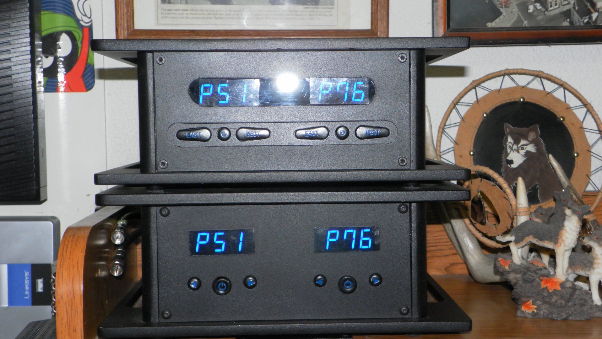

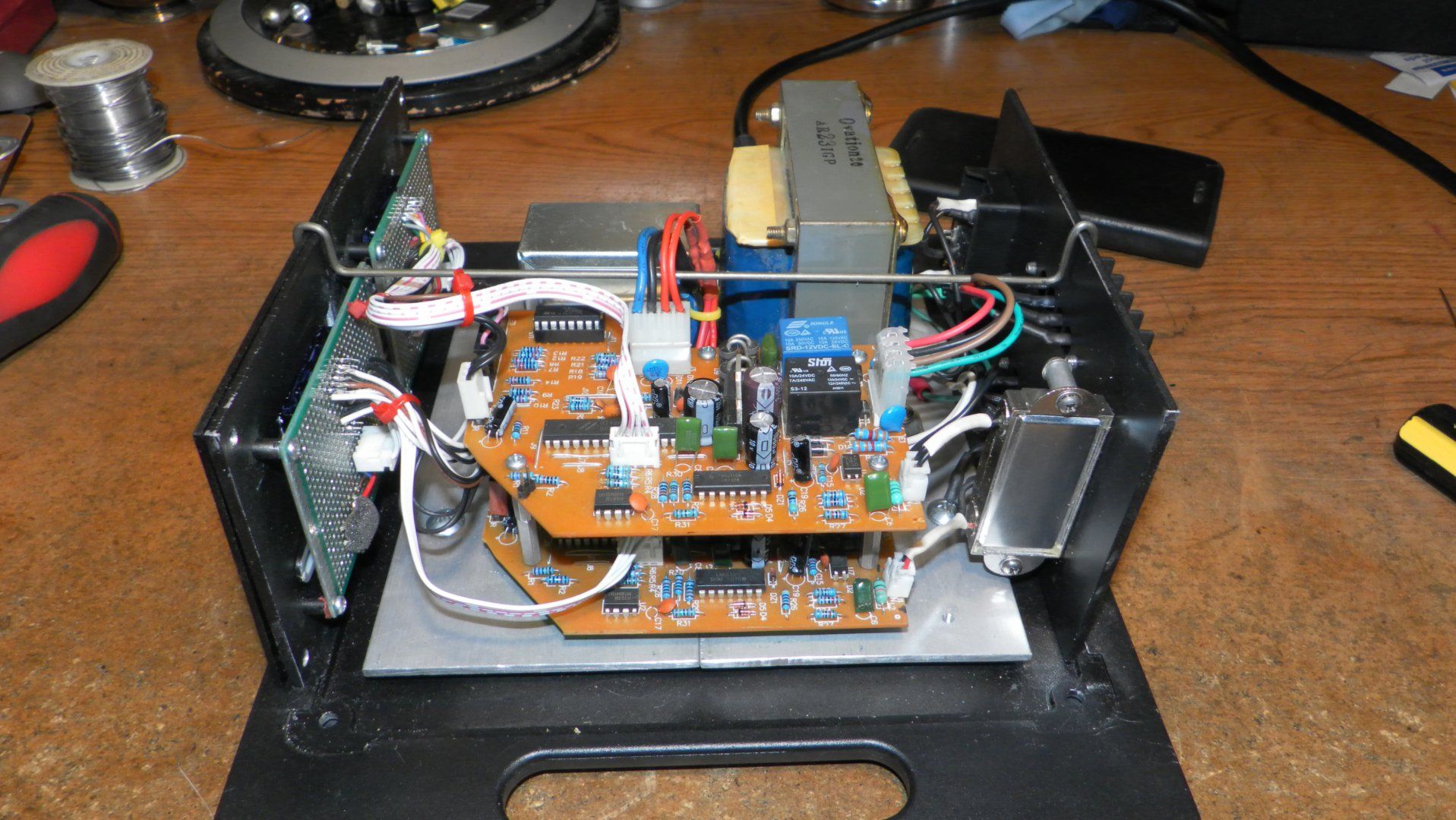

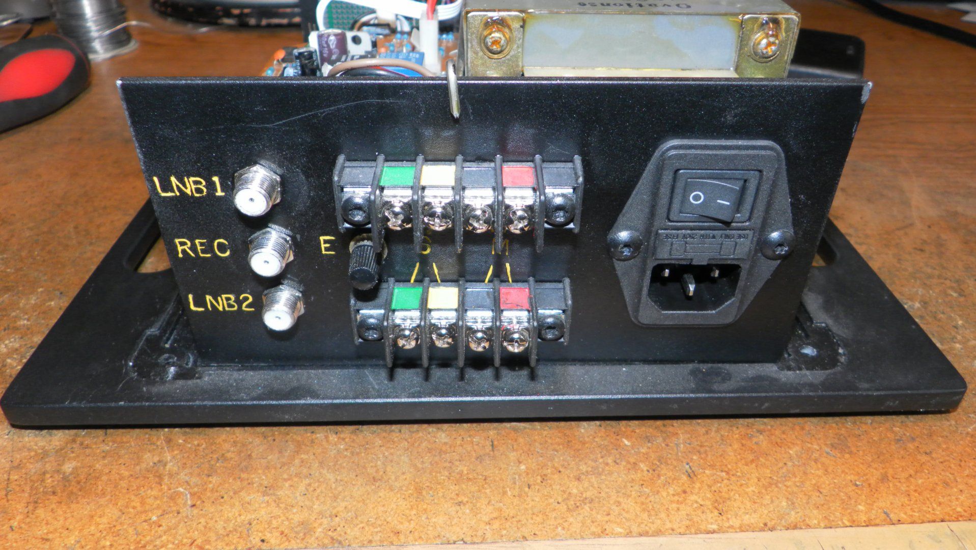

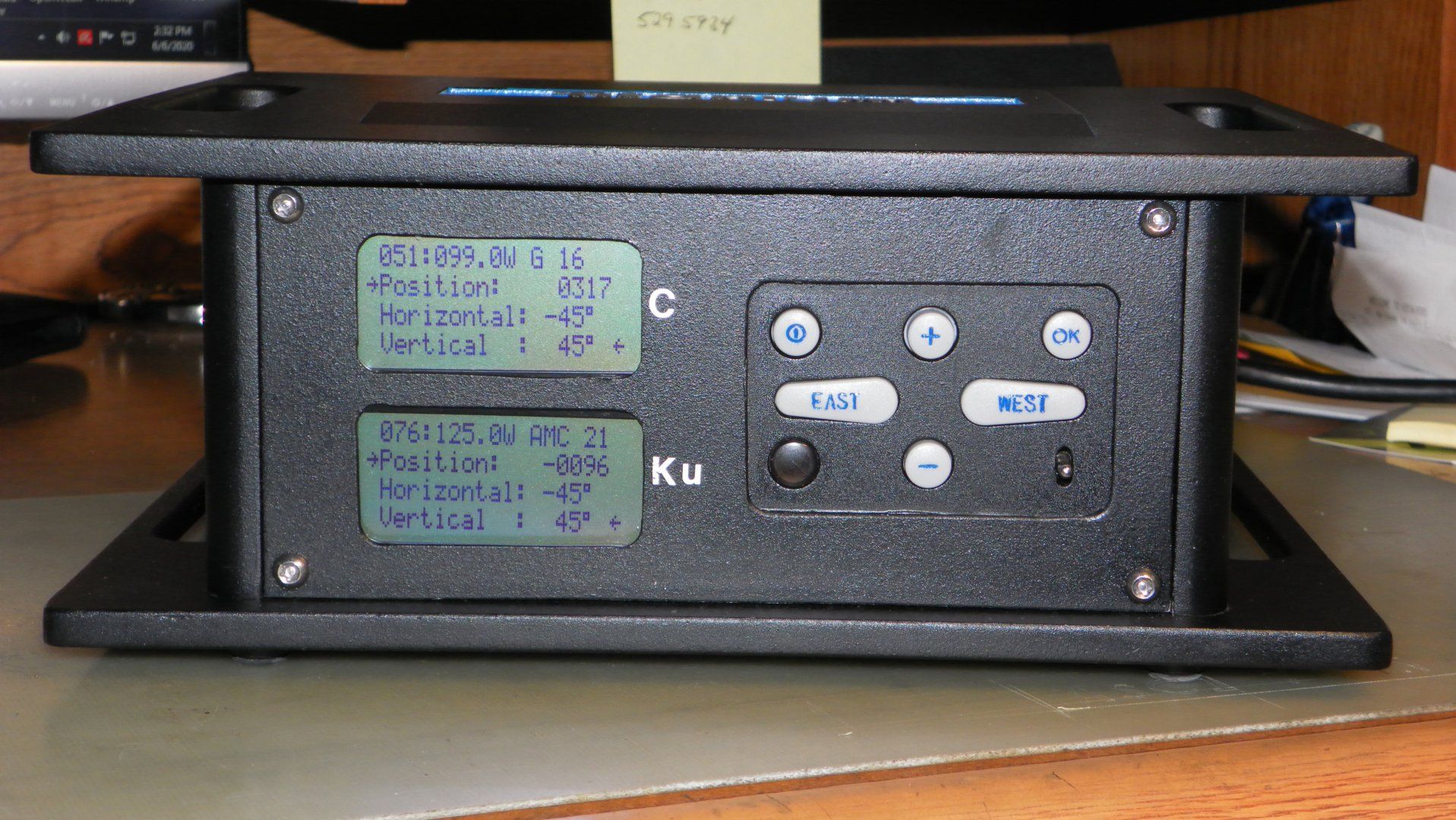

I have gone the same route, a Ku dish and C-Band dish each on a V-Box controlled by the same receiver. I use a common DiSEqC 1.0 1 X 2 switch to combine them. While this works very well there is a possibility to get your DiSEqC 1.2 position calls mixed up so I made sure that the V-Boxes do not have the same position numbers in them. So my Ku dish positions are all even numbered and the C-Band positions are odd numbered.
And I took the V-Boxes to the next level and put both of them in the same case sharing a power supply. I also moved the DiSEqC switch inside the case thereby eliminating the F Bridges and cables connecting them together. Also built a backup spare unit. :)

And there is another glitch you can avoid with the V-Box. Since a V-Box will also respond to DiSEqC 1.0 commands for the positions 1 ~ 4 until it sees a DiSEqC 1.2 command, I don't use positions 1 ~ 4. Every time a power outage occurs the V-Box resets to accepting DiSEqC 1.0 commands until it sees the DiSEqC 1.2 commands. Since you would be using a DiSEqC 1.0 switch to combine the boxes the V-Box would also try to move to position 1 or 2. If they are not used it just ignores those calls.
Thanks for your reply. I just want to make sure that I understand this. You don't recommend using positions 1-4. For example, if 139.0°W is normally position 1 for me, I should start with 5?
I guess I don't understand why the V-Box only responds to DiSEqC 1.0 commands for the positions 1 -4, and not 5 and above until it sees a DiSEqC 1.2 command.
Nice work on the retrofits!
The V-box can be controlled with either DiSEqC 1.0 (4 positions) or DiSEqC 1.2 (99 positions) protocol. DiSEqC 1.0 only supports port 1, 2, 3 and 4 and typically used for switch control, but V-boxes have added the ability to have 4 satellite positions to be selected by these four DiSEqC 1.0 commands. This was likely done to provide limited motor support for STBs that do not support DiSEqC 1.2 protocol.
