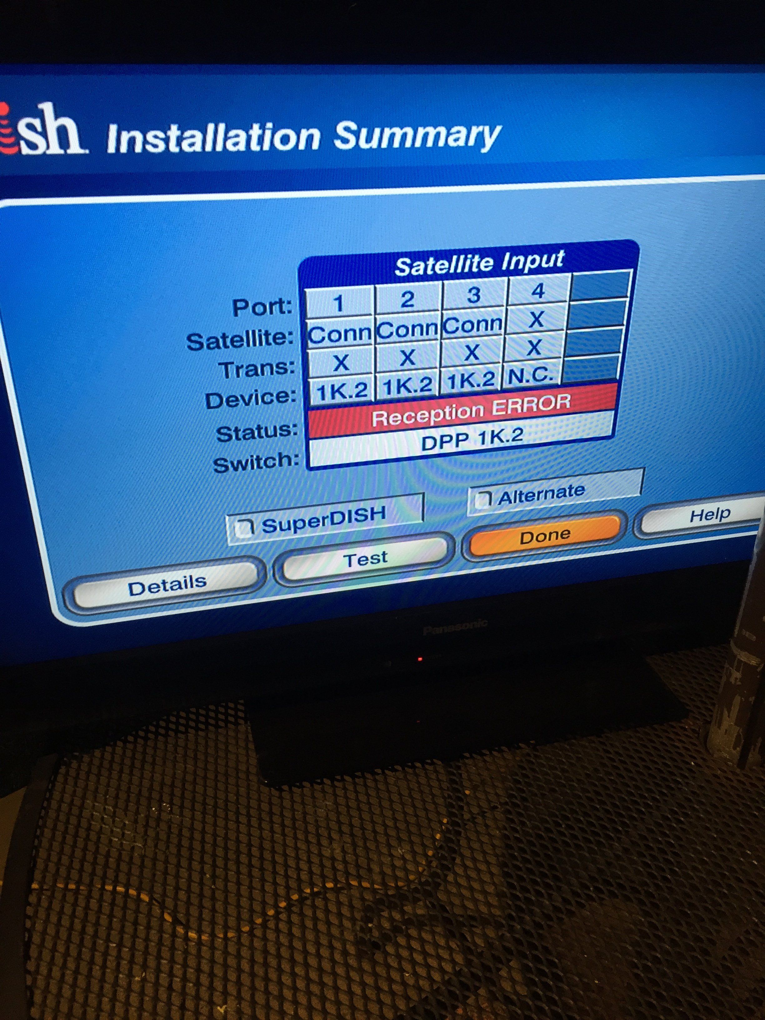

It just finished performing a test and here is what's on the screen now.
Take that receiver to your house, hook it up and run a check switch. Bring it back out to your tailgate and go to the point dish screen and put it on 119 transponder 7 and see if you can find signal that way.

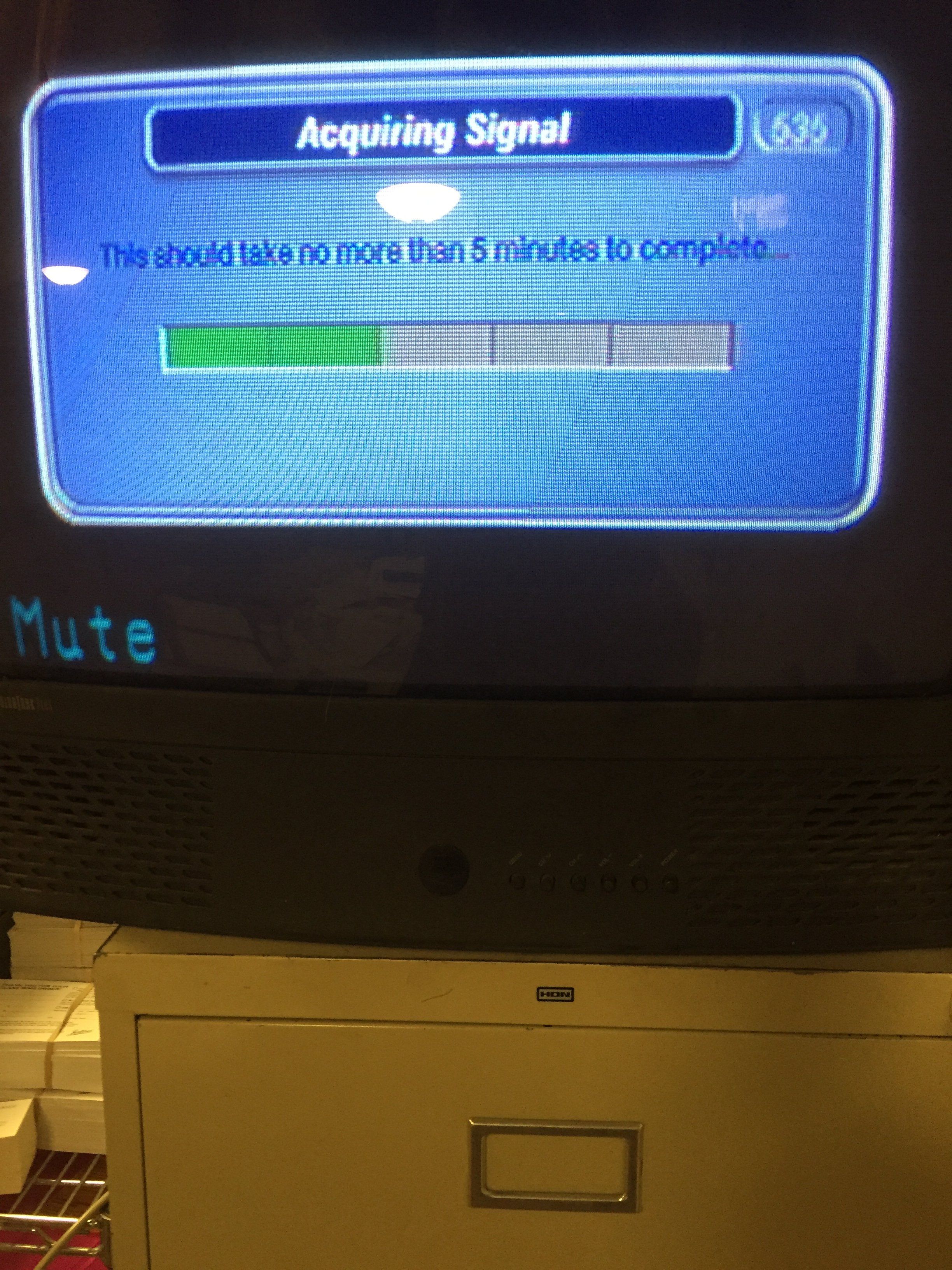

Stardust3- it ran the check switch test and now it's acquiring signal.
Now it's downloading the Program Guide - this is in my home.
Yep, I've got all of my channels. I think the receiver is good.
Now I'll take it outside and follow your steps

Don't run check switch anymore at this point now that you've got a good matrix with all green.
