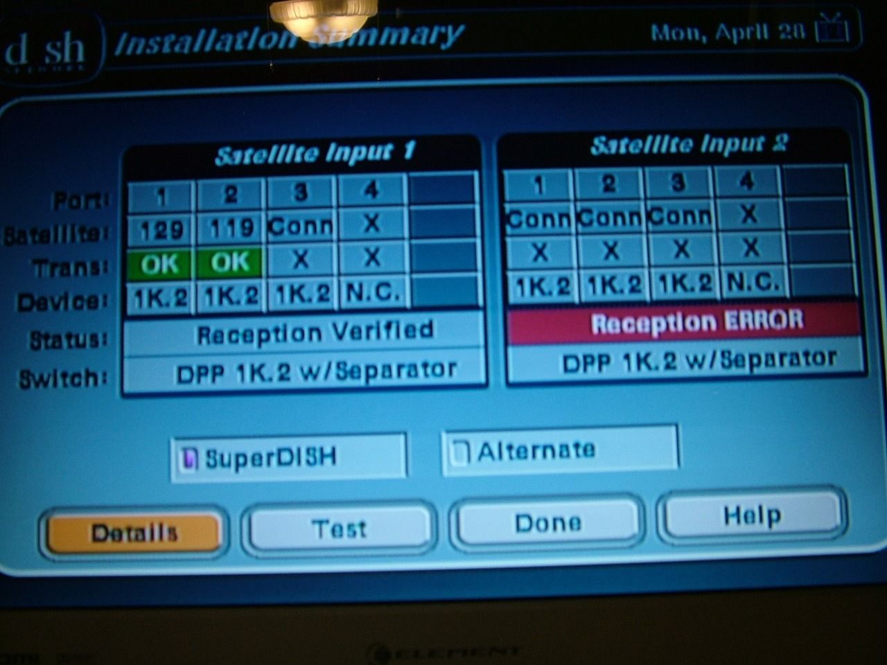

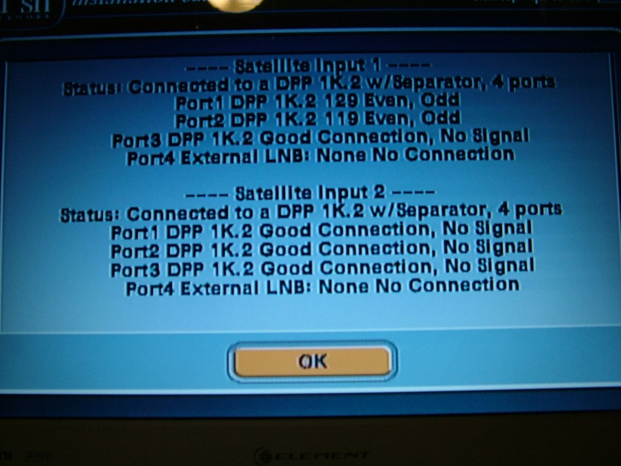

Ok I hooked up just one cable to my 322 reciever that goes to my second tv. Did check switch and I've included 2 pics from the check switch screen.

You're definitely picking up 129 with the 119 eye. I'd say cover the outside lnbs and aim for 119 until you peak it. Swing the dish to the left if standing behind the dish.
You could test right now by covering the middle lnb and you'll see that 129 will not show signal.
