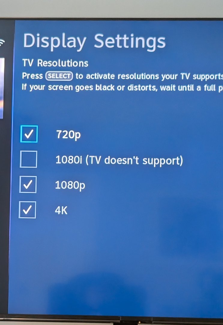

However, when I scroll through the information banner to change the resolution (other than when I am on a 4K Channel), the best I can do is 720p.
In the DirecTV resolution settings, 720p, 1080p, and 4K are checked, but I can't check the 1080i box because it states the TV doesn't support.

So the bottom line is, I hope I didn't just buy a new QLED, and not be able to watch 1080 from my DirecTV 4K box.

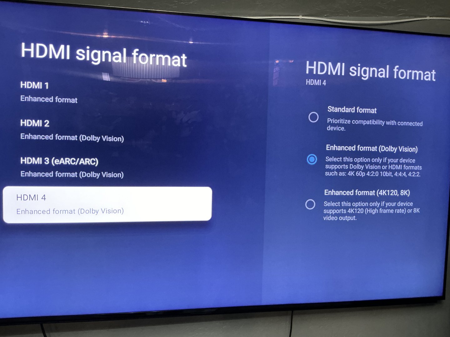

Actually, you might need to go into your menu, change the input to enhanced.
I have two Sonys, the inputs that would take a 4K/DV signal, I had to switch it so it would.

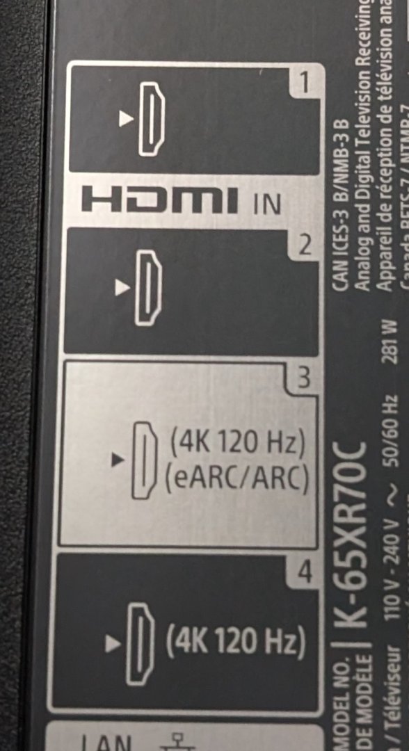

Also, the Bravia 7, only two inputs that will take accept the 4K signal, unfortunately, one is the eArc port, so you might need to check what input you have it in.

I'm using the HDMI eARC for my Bose soundbar. I'm using the other 4K HDMI for my Dtv mini 4K Genie.

You never answered what port.
HDMI 3 is for ARC.
HDMI 4 is HDMI 2.1, use that one, should give you the least amount of trouble.
But you need to change it to enhanced in the menu

•Yes, my soundbar is connected to eARC which is HDMI 3.
•My DirecTV client is connected to HDMI 4.
•I have a Blu-ray in HDMI 2.
•All inputs are in enhanced mode.

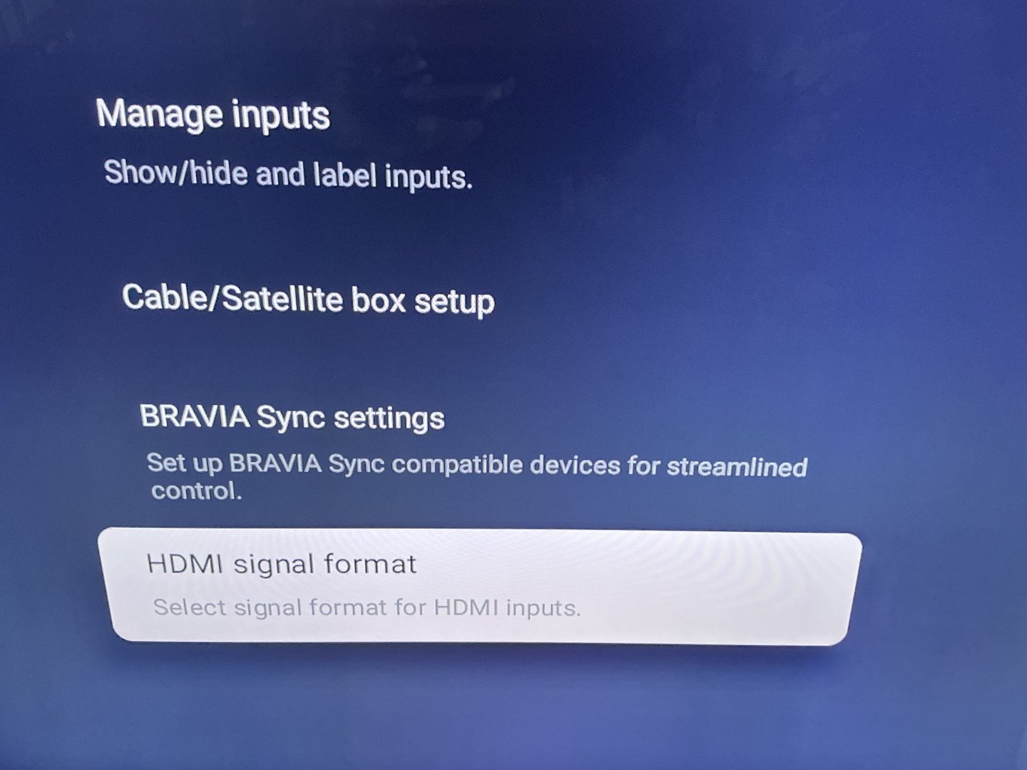

The only thing I can suggest, go into his menu and check your inputs again, here is my Sony Z9K (2022)-
Thanks, I know all inputs are "Enhanced Format", but I'll check and see if they're Dolby Vision or 4K120,8K.
Maybe THAT would make a difference.
