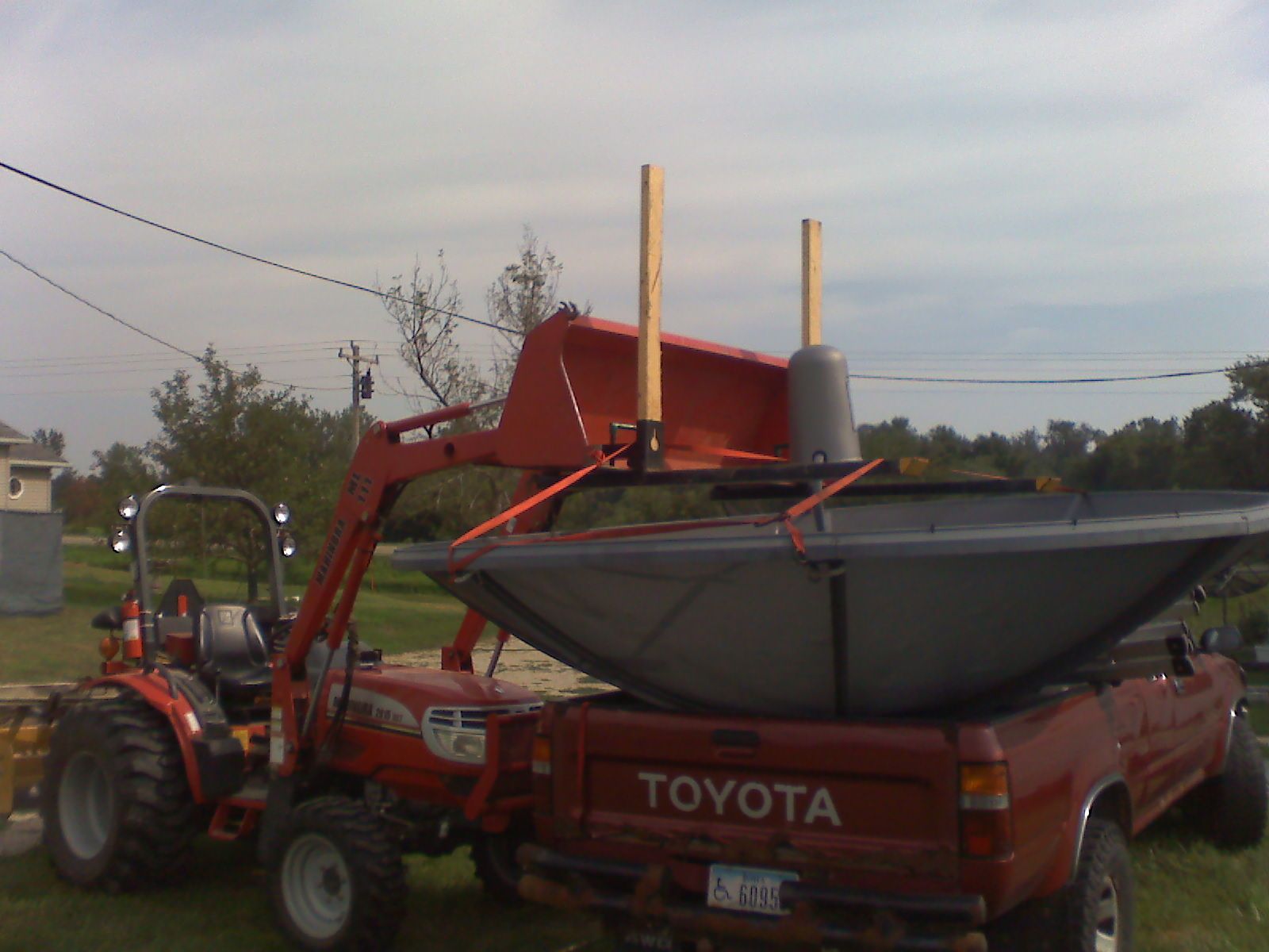

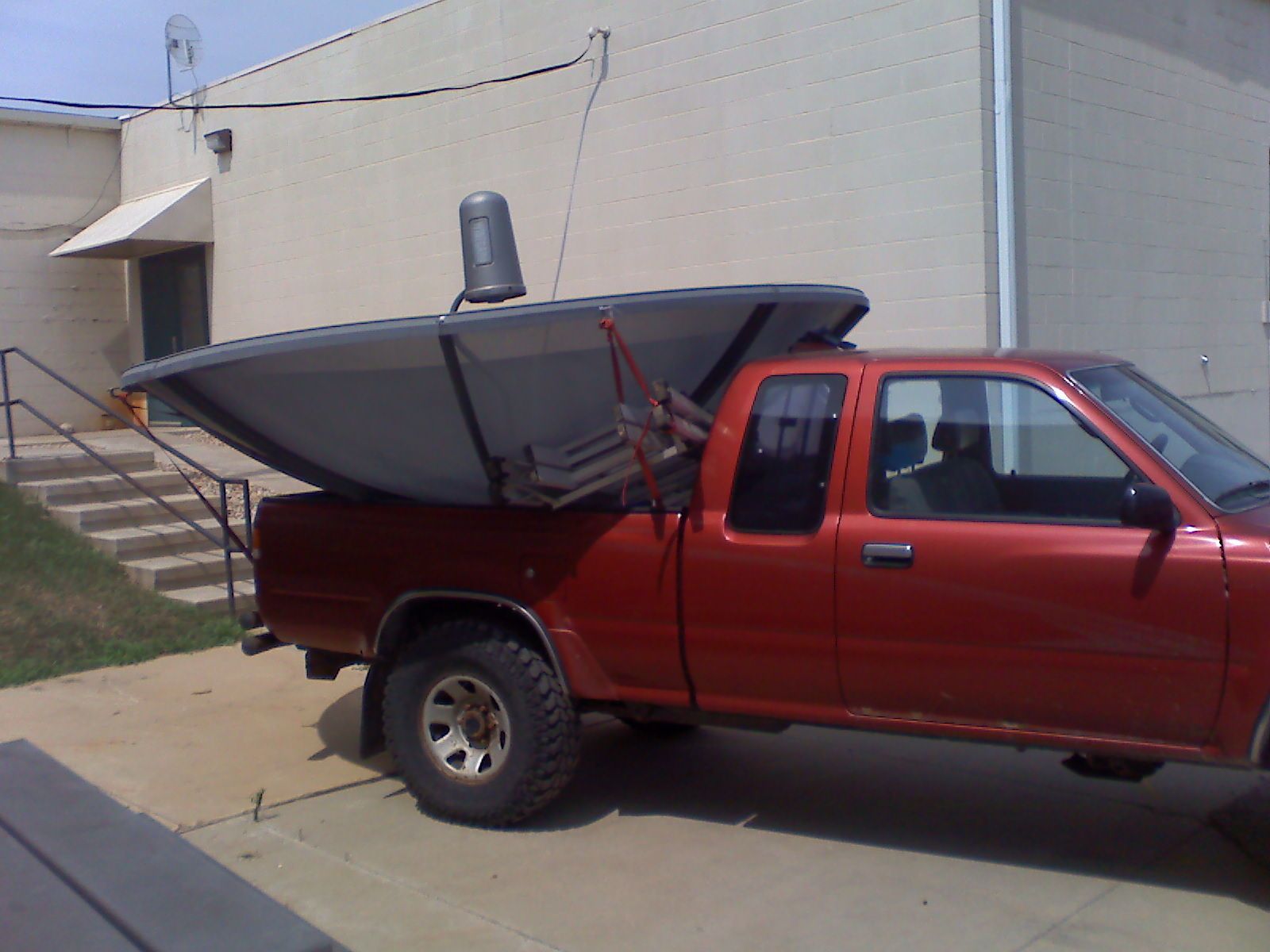

Today I took time to get the Winegard 10 footer that I saw last year. Loaded it on the Toyota and got it home and unloaded for storage and mostly a spare.
