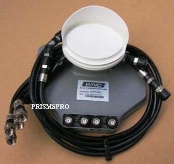

It sounds like you don't have an SL3, but a regular Slimline. Can you post a picture of it?
Its a WNC LNB model # SL3PIG..something. It's not the 5 LNB, I have one of those too;)

Normally the 22 kHz tone is used to select 110/119 in place of 101. However the SL3 LNB selects 101 whether or not the 22 kHz tone is there, so with a receiver set up for a 5 LNB system, selecting 119 will really select 101 (this is done so that there will always be guide information available). Redo the satellite setup for the correct dish/LNB and it will work correctly.
