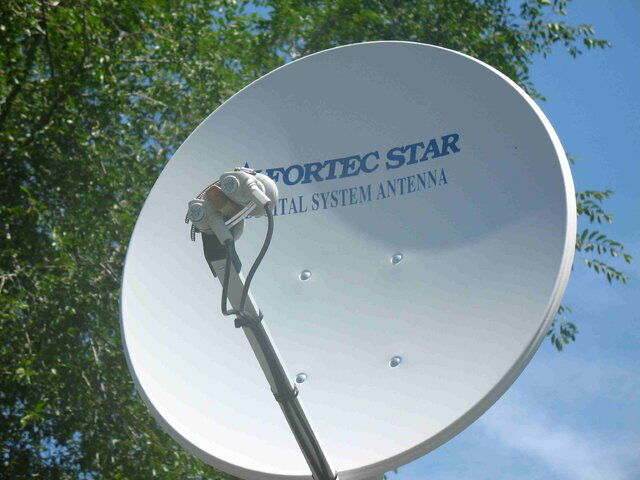

little more advanced...yes. Just put the 2 LNB's right next to each other. You may need a spacer (1/2" piece of wood works good) and a hoseclamp but yes it can be done. I did it for a while and I know others have too :)
edit: found a pic of that particular setup (courtesy of iafirebuff)
(the 129 LNB is on the right...when dealing with multiple LNB"s they go opposite of the clarke belt)

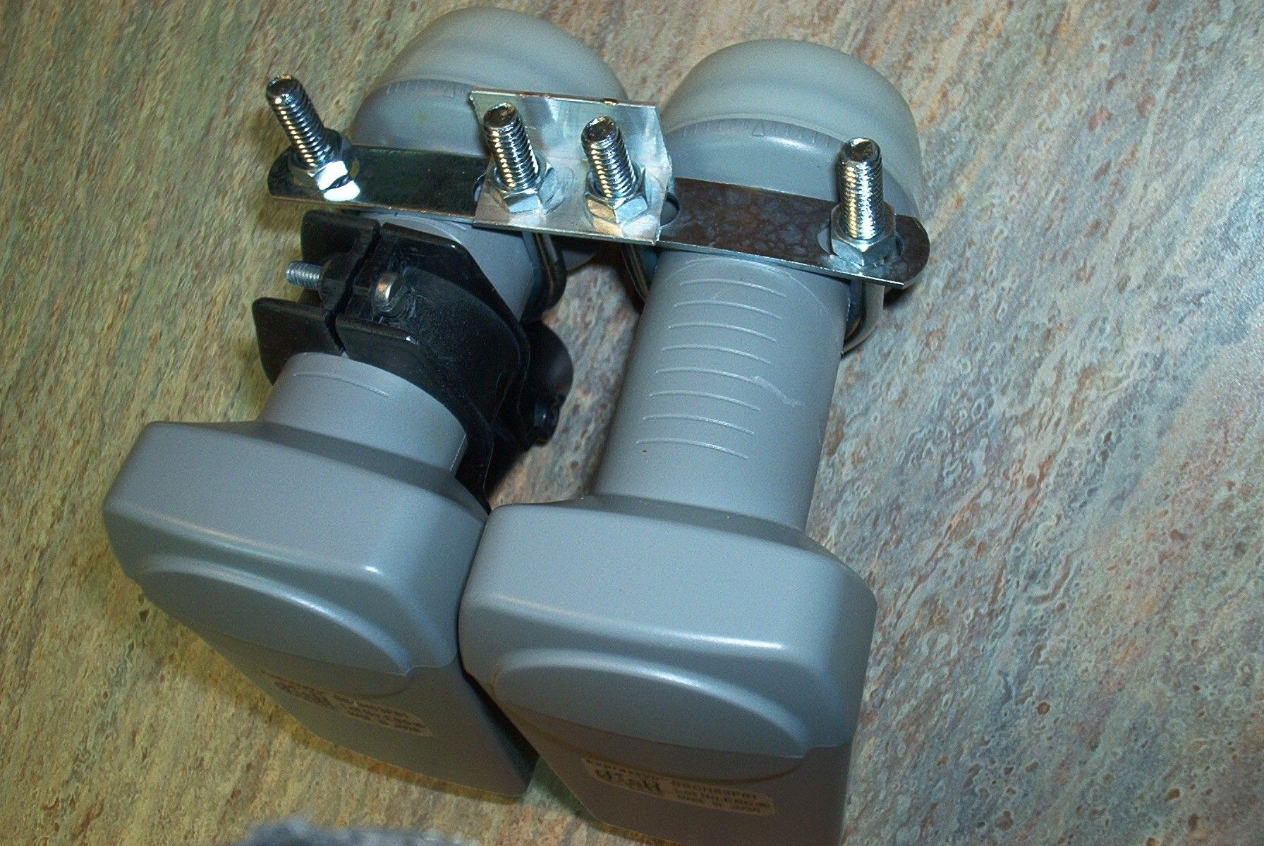

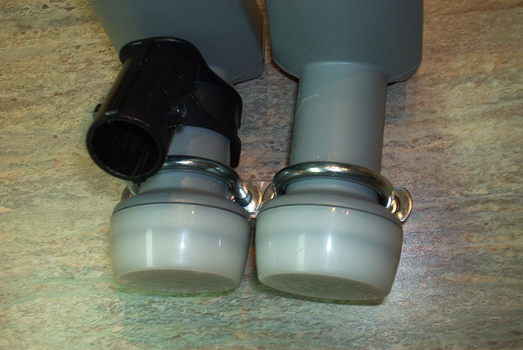

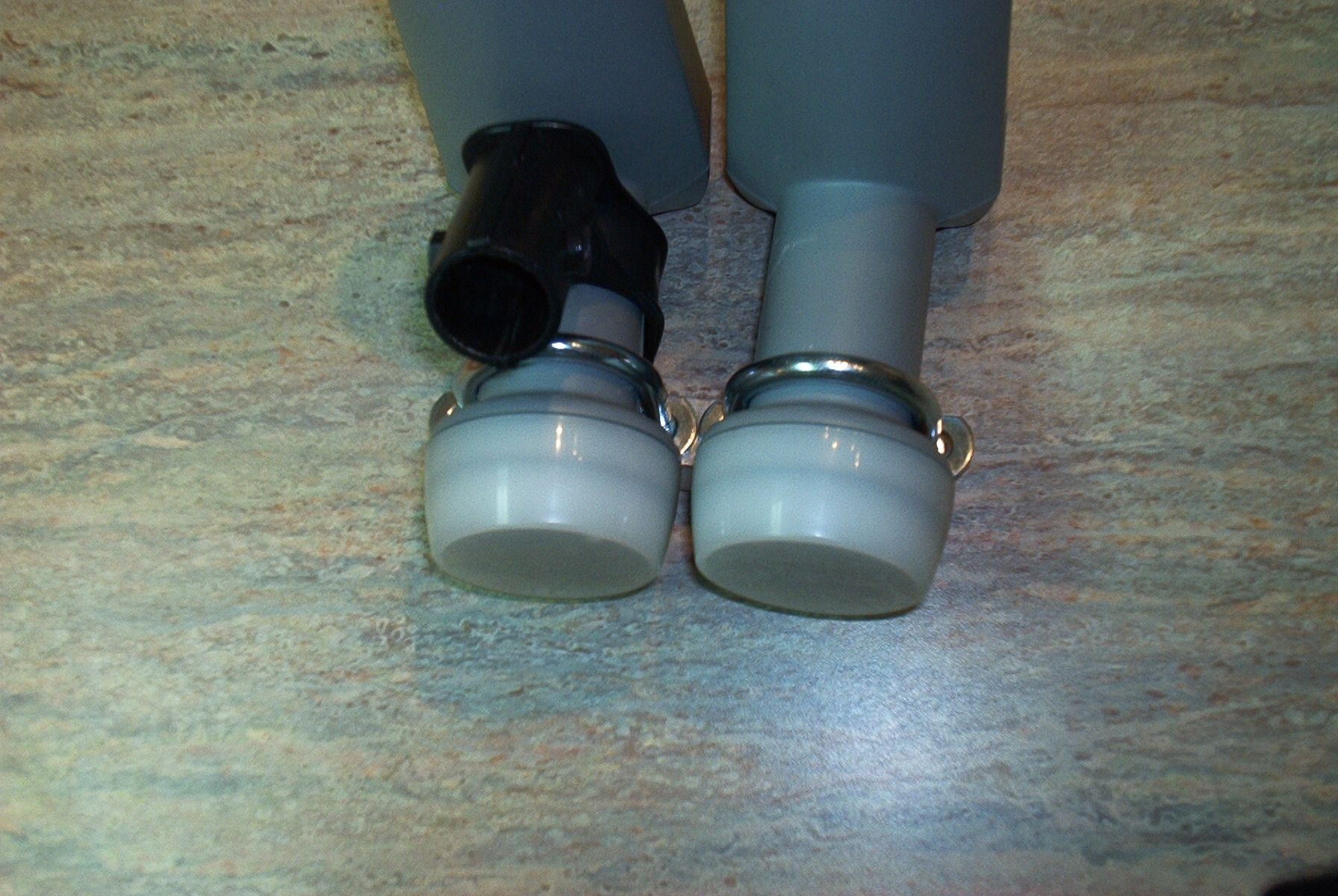

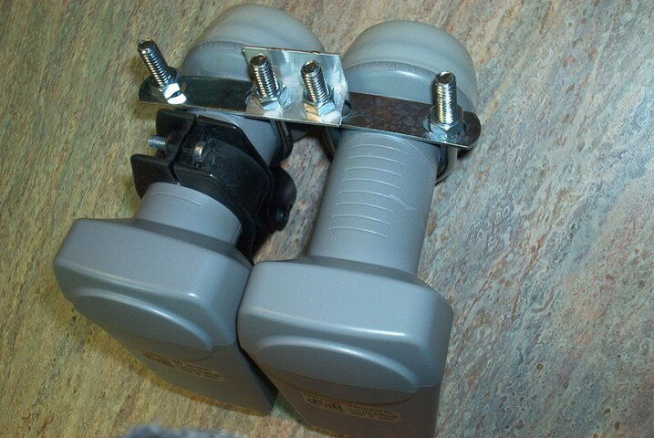

I have found it easy to attach additional LNBs with U-bolts. You can also adjust the spacing on the 2nd LNB with the spacing of holes on the metal strip holding the two LNBs together. (See atttached)
