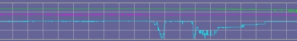

I decided to start graphing the signal strength of the main PBS mux (12,180 MHz), Montana PBS, and OETA. This morning the signal from OETA started dropping quickly on my graph. My receiver showed no signal. The weather radar showed strong storms over Oklahoma. So now I know that the problem is not on my end and other than getting a bigger dish, there is nothing I can do about it.
Green-PBS 12180 MHz. Purple-Montana PBS. Blue-OETA
The graph is for about a five hour time period. Each vertical division is about 4 or 5 db. In order to keep the 3 channels from graphing on top of each other, I offset each one from the baseline. So it doesn't show that one channel is stronger than another, just how steady or not each individual channel is.

Gotta remember that they use much larger dishes. I kinda doubt that any of their downlink sites has anything smaller than an 8 ft. (just a guess tho-)
I think I'm lucky to get 'em on an 84e with the reliability I experience.
