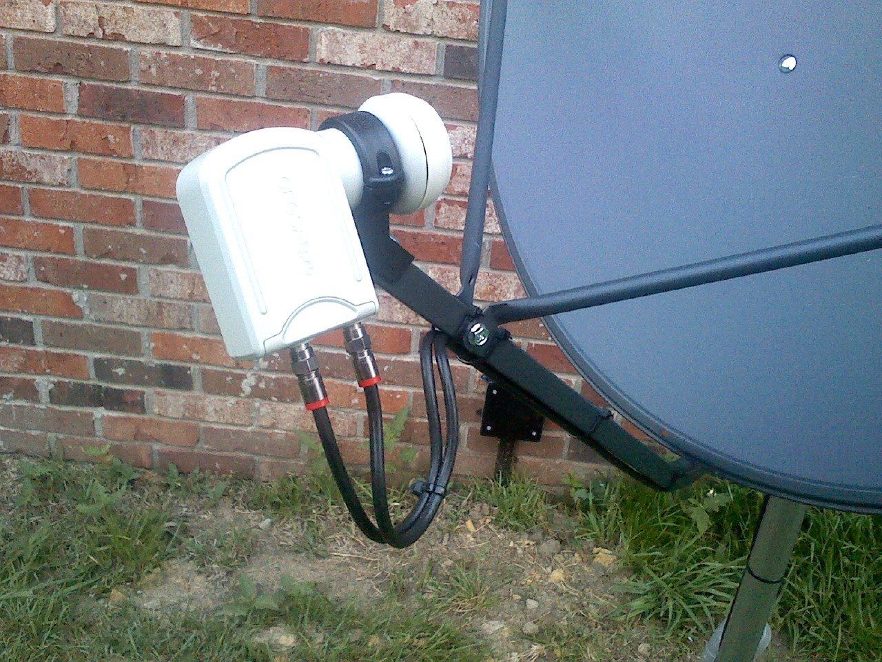

Got a Cheap Box from Amazon to try and get the radio feeds in another room to re-broadcast Part15 around the house.

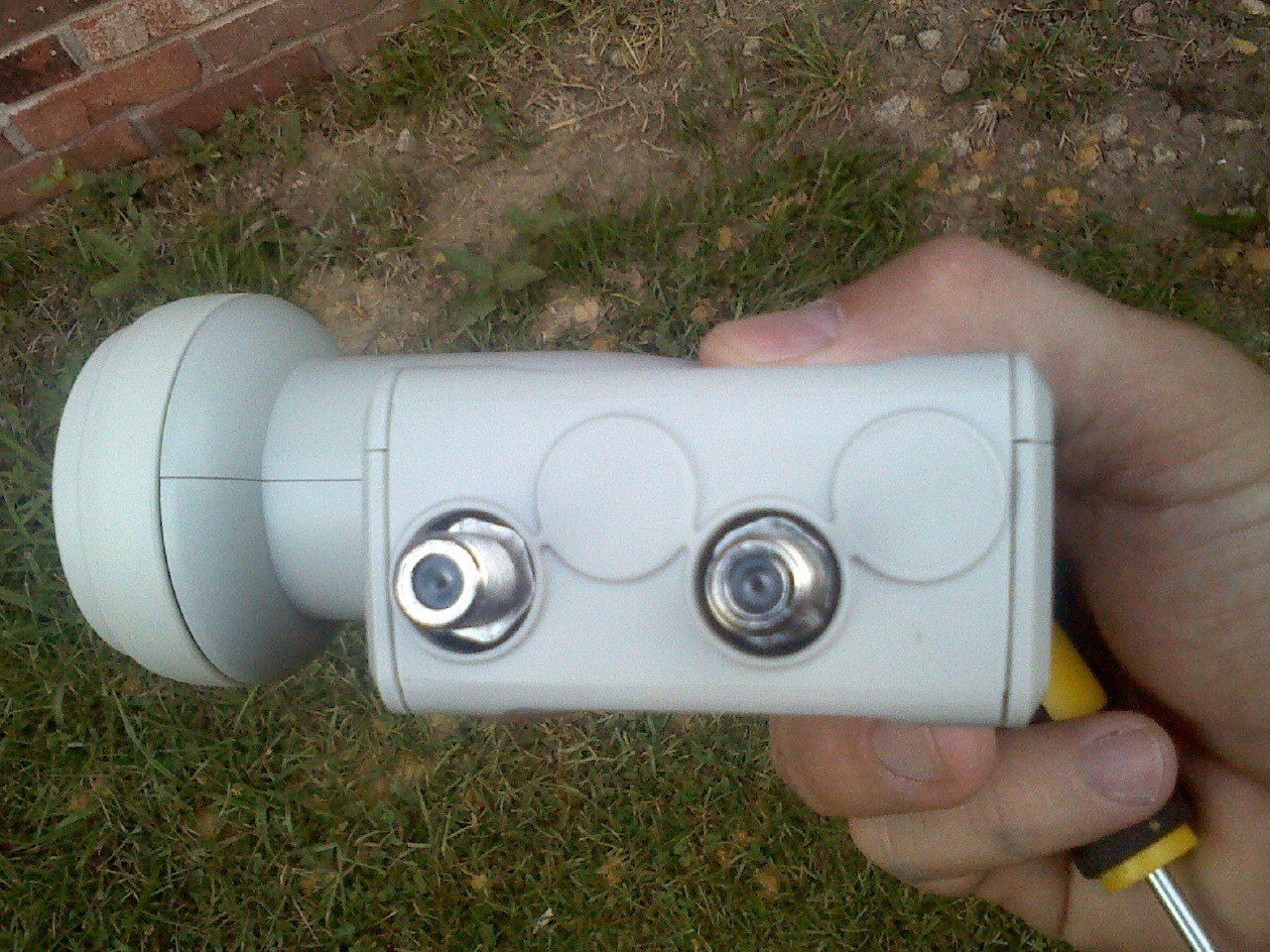

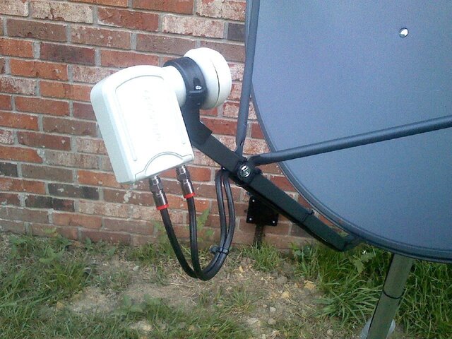

And a GEOSAT pro Dual-Ouptut LNBF from KE4EST! Looks to me like it could be molded for 4 outputs as well?
Here it is on the Dish....will get the box connected later on.
