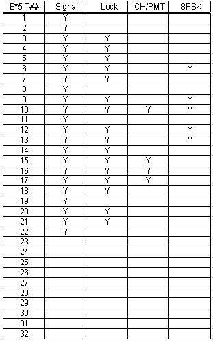

129 on superdish 121
Now that 129 is back up I verified this is working.
