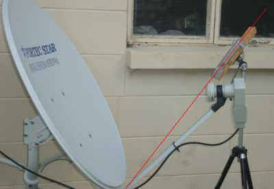

Delta_Charlie,
I like the "Bore Sight" through the straws. You get two AttaBoys.
The red ray in attached picture kinda supports the www.satsig.com rule of thumb for offset dishes. View from the bottom of dish arm over the top of LNBF to see about where satellite is. But your method is better because you can sight from the East and West sides of the dish.
