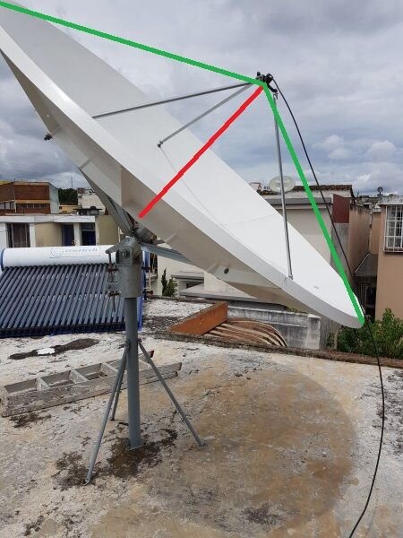

enb141 Are you sure you have placed LNB in proper position? Did you measure your dish and calculated it's focal point? It is not right to use LNBs designed for offset antennas on prime-focus antennas, as they have quite different F/D. Look for LNBF like GI-209P, it does not cost a lot but works well on PF dishes.
And, yes, post some pictures of your installation, please.
Hi, thanks for the response, yes, I'm aware that prime focus dishes need prime focus LNBs that's why I was previously using an invacom prime focus LNB + C120 feedhorn shown in the pictures. Then the other guy, Brct203, suggested to try another LNB, right now I only have offset LNBs to test so I did the test but the results were pretty much the same in comparison with the invacom + feedhorn lnb.

It does not really matter what LNB-holder you use, more important is that holder holds LNB in proper position. Did you measure your dish and calculated position of it's focal point? The focal distance for PFA I marked in red line. LNB should be pointed directly to the center of the dish. And also make sure that LNB is located exactly in the middle of the dish (green lines are equal).
Do you have possibility to exactly measure the leaning of the dish?
And what about blue line and yellow line?

Blue line: diameter 240cm (2.4 meters), don't know about the yellow line because I would need another person to help me to read that value.
Blue and yellow lines are main measurements should be done for PFA. If the dish is 2.4m it does not necessary mean that it's working area is exactly 2400mm. When you have your friend over to help you to measure yellow line, just in case you also take precise measurement of the blue line. When you know exactly blue and yellow you can calculate red and green lines. And then make sure that calculated red line equals to measured red line.
BTW, I have measured my 4.6m PFA without any external help.... I mean it is possible. :)

Fix string across the "face" of the dish, mark points where string touches edges of the working area. When string is still across the dish use measuring tape to measure the depth of the dish.

And, BTW, you better check geometry of the dish by string test. After reading the manual I see that is very important to follow assembly procedures. It is also written in the manual that focal distance of the dish is 35.8 inches which is 909mm (exactly as you have said before) . Anyway, I think it is nice dish, designed for Ku/C reception, so it should work as 2.4m. Double check all the distances (colored lines), use LNBF for PFA and results should come. If you wish I can look for GI-209P in our shops and sen it over to you. I had good reception results using such LNBF.

I was lucky, my brother came today and he helped me to measure yellow and blue.
Blue 243 cm
Yellow 40.5cm
