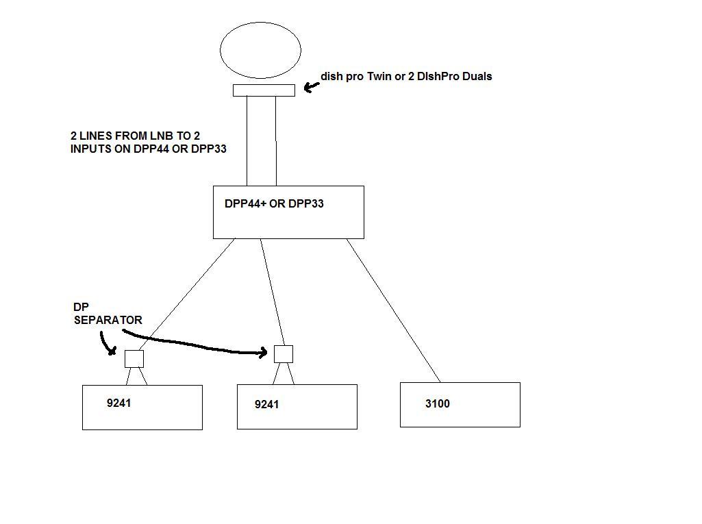

Yes, it's the old set up with two LNB's and an SW44 switch. So I'm assuming if I get the DPP44 and a couple of Dish Pro Separators that will be the easiest way to do it? That way I can run the 4 lines off the LNB's into the DPP44, then out of the DPP44 run 2 lines into each Dish Pro Separator and then voila!! Single lines out of the separator to each 9241? Then of course just a line off the DPP44 straight to the SD 3100 receiver?
Is this right? or am I missing something?
Thanks again for you help.
GC
you would have to switch the LNB's out too since they are considered Legacy and you need DishPro...lemme draw up a setup and post it
here is the pic

Simplest/cheapest thing to do would be to just order a DishProPlus Twin and a couple Seperator's (1 for each 9200). That will allow you to have 3 boxes hooked up.
The DishProPlus Twin has 3 outputs, and eliminates the need for an external switch.
The Seperators allow only 1 cable run to a dual tuner reciever when used in combination with a DishProPlus switch and/or lnb.
You order what you need from dishstore.net
DishProPlus Twin - $38.99
Seperator - $6.50/ea

A DPP Twin only has two outputs so it wouldn't work for the OP. Bell has started using DPP Twins fyi. But for more than two receivers they still use the SW44.
You're right. For some reason I had it confused with a DPP 1000 lnb.
I'd still get a DPP Twin over a normal DP Twin, as the cost difference ($5.00) is neglible, and allows more flexibility in the future.
For 3 recievers then, a DPP33 ($34.00) or DPP44 ($79.00) will be needed.
you cant use a DPP Twin and a DPP44 together. I've heard they dont work properly with a Dish system....so a Bell system it probably would blow up ;)
I've been using a DPP Twin with a DPP44 on Bell for a couple years now, no problems.
