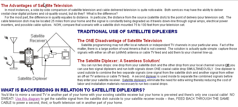

The older RCA antenna should work with what ever you setup you finally go with.. Is this a VHF only or an all channel (UHF&VHF) antenna knowing that would help.
Also are you wanting to use the switch for the TV in the bedroom? Also,when one combines OTA (the Antenna) with a Dish, it's done via two or more Diplexers, so are you using them or a standard splitter.
Diagram link for additional set which may not apply in your case.
http://www.satelliteinstaller.com/My eBooks/PROBLEM_SOLVER_1.pdf
The older RCA is an all channel. This is for the bedroom tv. I currently use the backfed sat signal on one side of a standard splitter. I also use a UHF signal on the other side of the splitter. Satellite works fine, but for some reason I get high VHF (7) fine but my UHF signals are are not coming through. I thought if I would instead run the backfed sat signal on one side of A/B switch and UHF on other side of A/B switch, I would get all OTA frequencies when on antenna. (The RCA antenna is not in the mix yet but was thinking of experimenting to get some analog out of Canada or a Fringe station in another direction.) I should resolve one problem before creating a whole new one eh? :)

I believe from what I'm reading your problem is using a standard splitter and not the diplexers, I maybe wrong but that's the first thing I'd be looking at as the problem.
