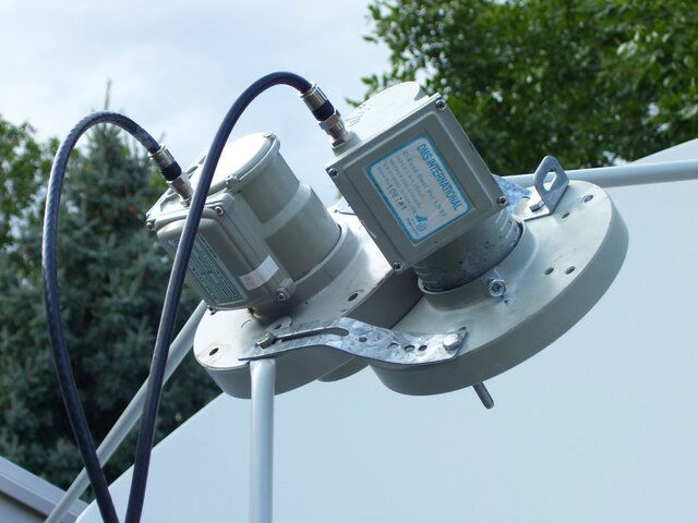

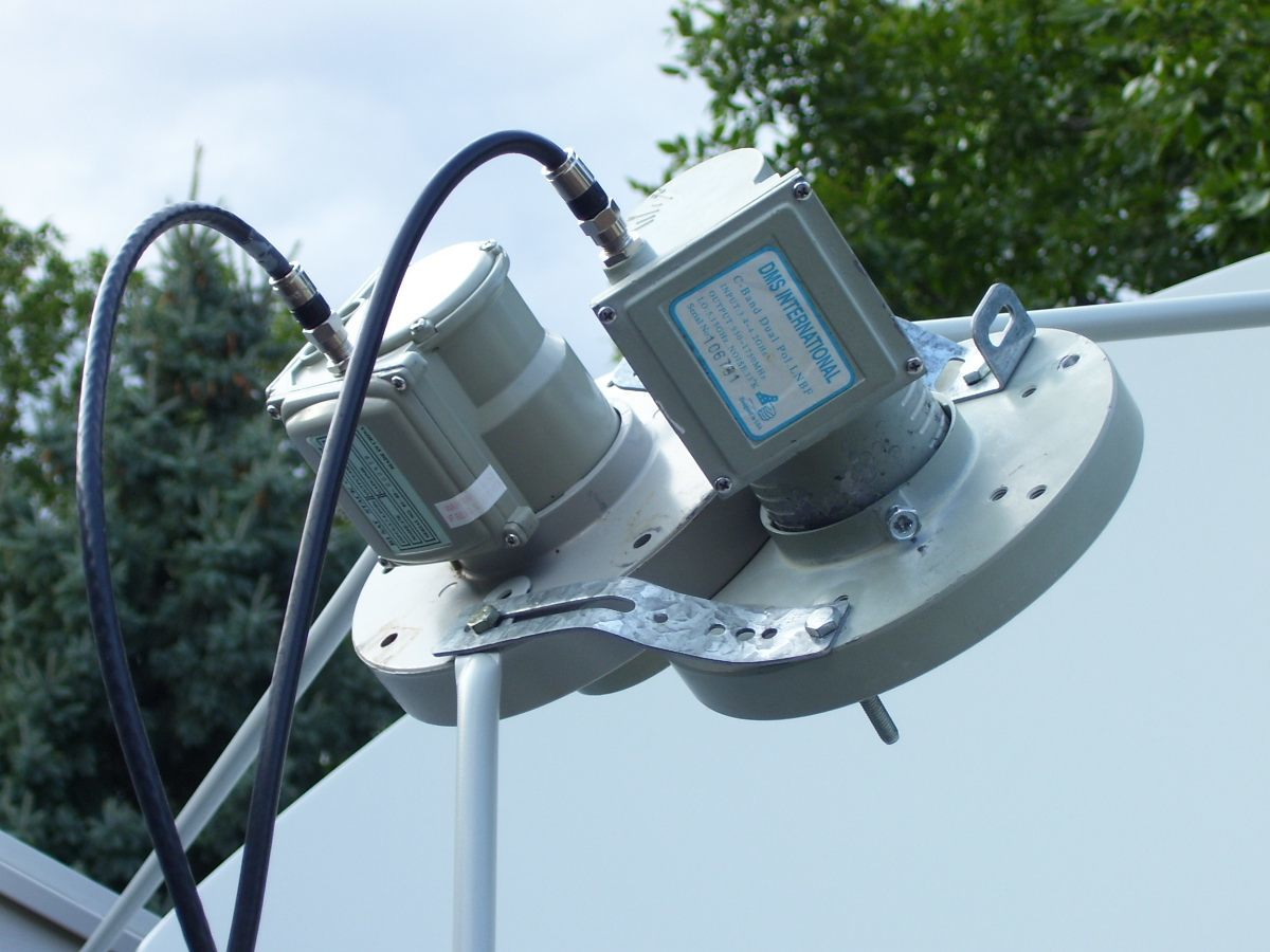

Well what started as "could I get C-Band on my Primestar" turned into another project...and a successful one at that
My 6 foot dish right now is at G17/G11 but I kinda wanted some of the stuff on G16. So I tried my P* and didnt get very far (due to too many dishes blocking the view) so I said screw it and then saw the big dish and thought...hmmmm
Now I had done this before as shown here when I did 99/103 but could I get 91/99?

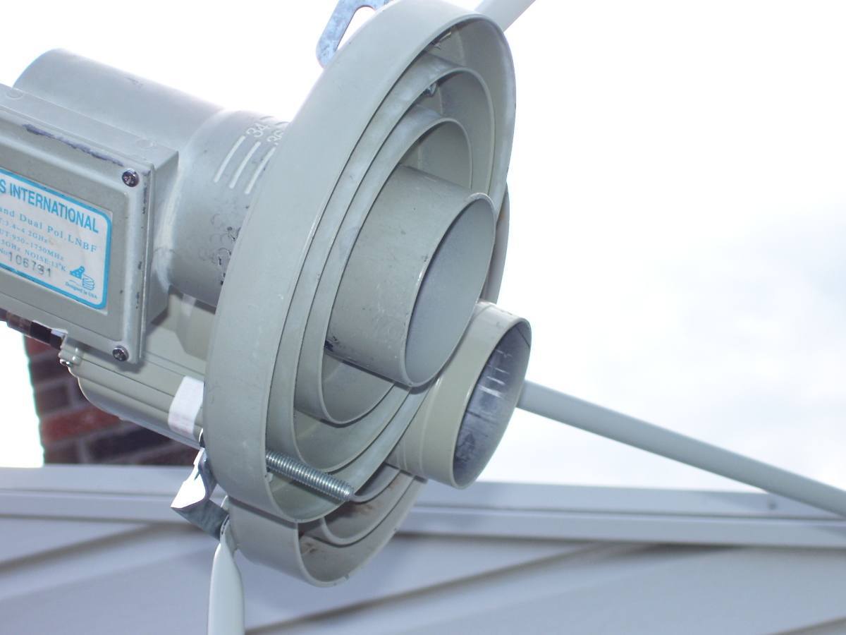

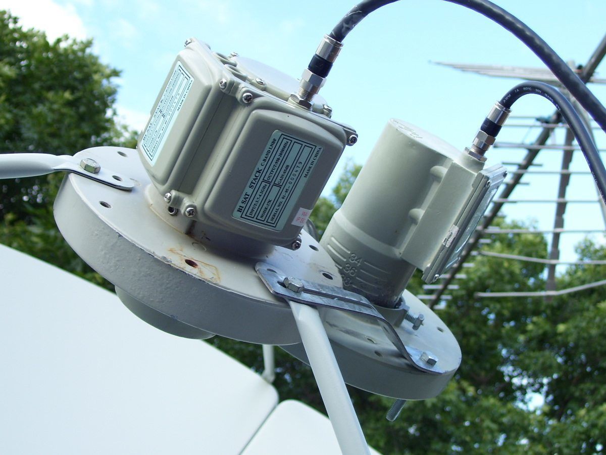

I took the LNB with scaler ring and put it up near the LNB...nothing....then moved it closer and BAM...the coveted networks.....I almost fell off the chair as I could never get them offset. Monkeyed around and got them around 50 quality just by holding the LNB there...World Harvest around 60, ABC HD 40 and a couple others near 60. If I took off the scaler ring nets were around 30 and ABC HD is gone. So I need the scaler ring on it

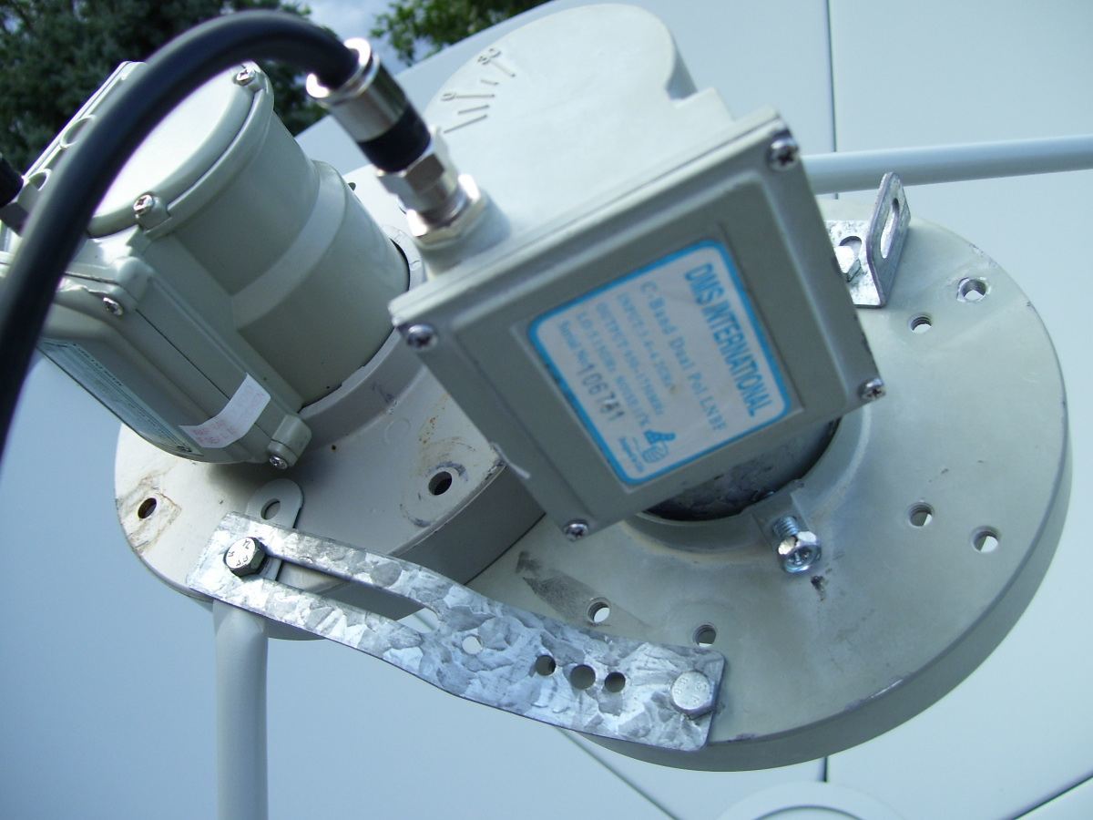

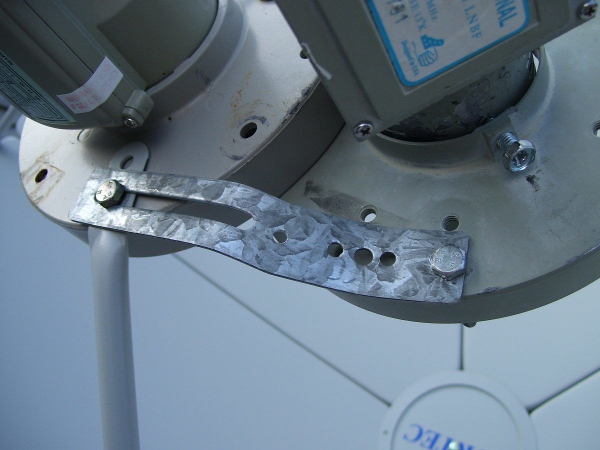

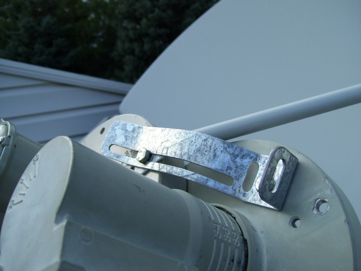

now how to fasten it. I had thought the Iceberg special (hoseclamps) but that didn't work. But as I was digging in the duffle bag for hose clamps I found a couple pieces of metal that had been used previously for the "get multiple KU LNB's on a dish" and then the wheels were turning.
removed the bolt from the scaler ring that was already there and put the bracket on there and fastened it to the 2nd LNB....stayed around 45-50. Found a different piece and put that on bottom and now it peaks at 60 :D
Checked against my other 6 footer that is locked on G16 and its not bad...1st number is the fixed dish at G16 (the one that I wheel ouot of garage) and 2nd is the offset one
Nets 89 60
WHT 90 65
ABC HD 50 45
NBC Casp 45 0

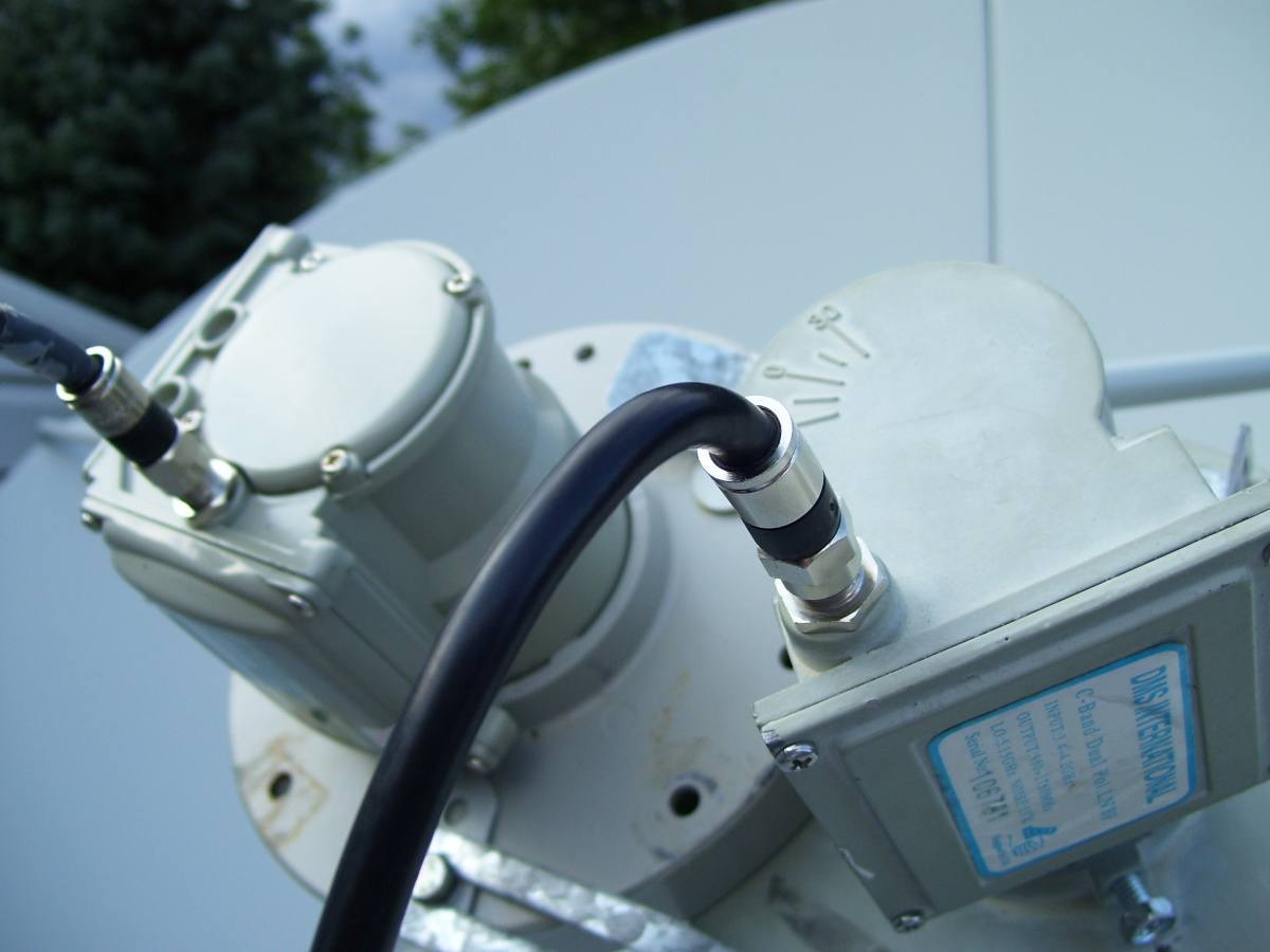

so all and all I'm happy. and here are pics :)

nice configgerin
I see the DMSI lnbf but what brand is the other one? Which one works best? Haven't yet bought a C-band lnbf but I like the idea of no polarity motor!

yeah its pretty nice. No need for 2 lines or a multiswitch. One line to a 4 way splitter
bad part is it doesn't work with 4DTV or analog boxes and some FTA boxes don't have the capability to have both on one setup
Fortec Classic does
Pansats do
Coolsat 8000, Visionsat & Fortec Merc II don't. Need 2 separate satellites. One with 5150 LO and one with 5750 LO

well using the theory of 8 degrees off (91 to 99) that would be 83. On C-Band you go from 72 to 87 until there is something C-Band so that probably isnt feasible. Also I luck out as my True South is 93 so 91 & 99 are almost same elevation. So Someone on the coasts may have harder time fastening it and figuring out elevation

nah...the 2nd C-Band since temporary has a line that runs into the house and gets hooked up to a box as need be. Since alot of C-Band is AC-3 I need the HD box so I either use the Coolsat 8000 or the Q. Plus the 99 LNB I'll just split the line and put DC blocks on it. Only the Q would utilize the V side. The other boxes in the house being SD only would use it for H only. This idea was mainly used for the nets

Very nice experiment!
Great pictures too!

I love that type of mounting hardware, you can quickly fabricate anything.
I had to laugh when it worked because all I did was dig in the duffel bag and found them
