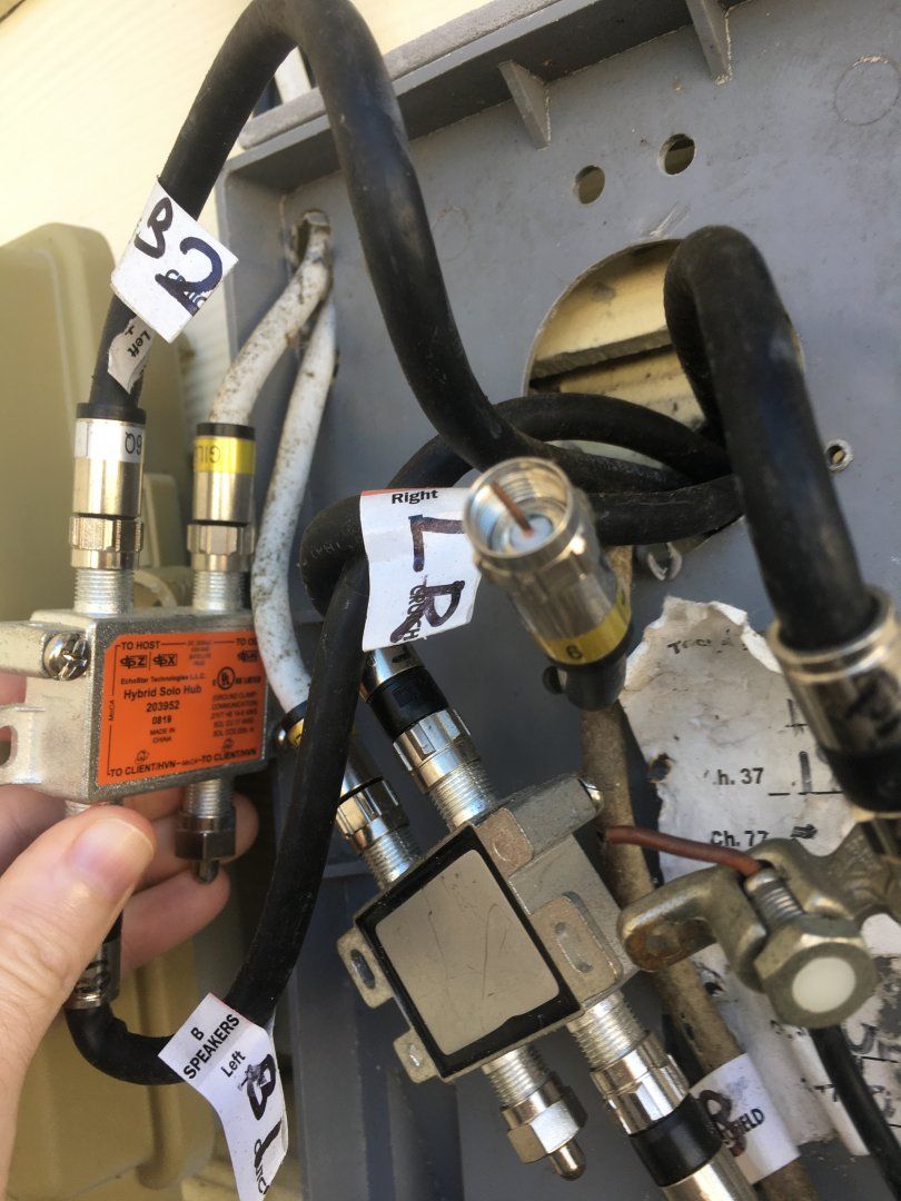

one dish is feeding both, I can get picture of how it it setup as i not entirely sure off the top of my head, I want to say it one big switch in there and 2 smaller ones? Big one is feed a the 2 smaller switchs Host (A) Client (A) and Host (B) Client (B)

Yes, the 42 switch is the big one and the other two are solo hybrid hubs.
Yah there is just 2 of those little switch, The big switch was used when it was just 1 h3 feeding 3 4 k joeys
B2=Hopper 3 #2 and B1= Joey #2 (I use this hopper for my joey)
LR=Hopper 3 #1 and MB= Joey #1 ( power insterted connected here between the cable line and the box)
White lines are from Dish
It been setup like since I first got it never had issue to recent. no clue if location of power insterter makes diffrence
Is this setup right? or wrong? or is there new setup? Like said Before I have tech come out 2 times prior they all said it was wrong tried diffrent and went back to this how it is right now is how I had initial setup, and tell 2 other that came out since then told me it wrong and try use diffrent setup

If the 42 switch, the big one, was used when you had a single Hopper it was used because they wanted to use your existing LNB instead of a Hybrid LNB. A single Hopper can go either way whereas two Hoppers require the 42 switch and a non Hybrid LNB configuration.
so they setup I have is the correct setup, and there is no other setup known currently? so id tech come out says that is wrong I should not allow them, unless they know for fact it works cause they actual done it and seen it work?

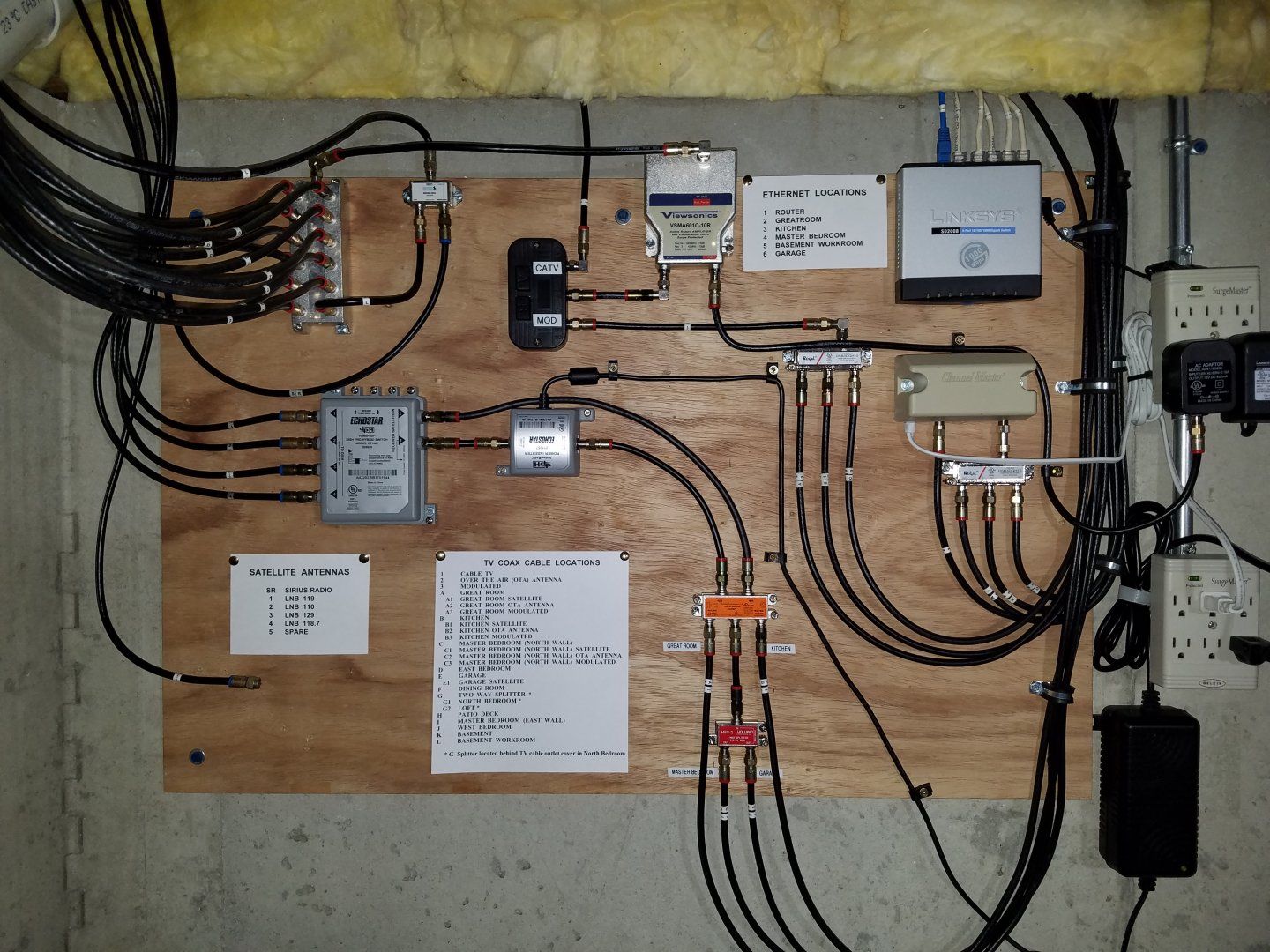

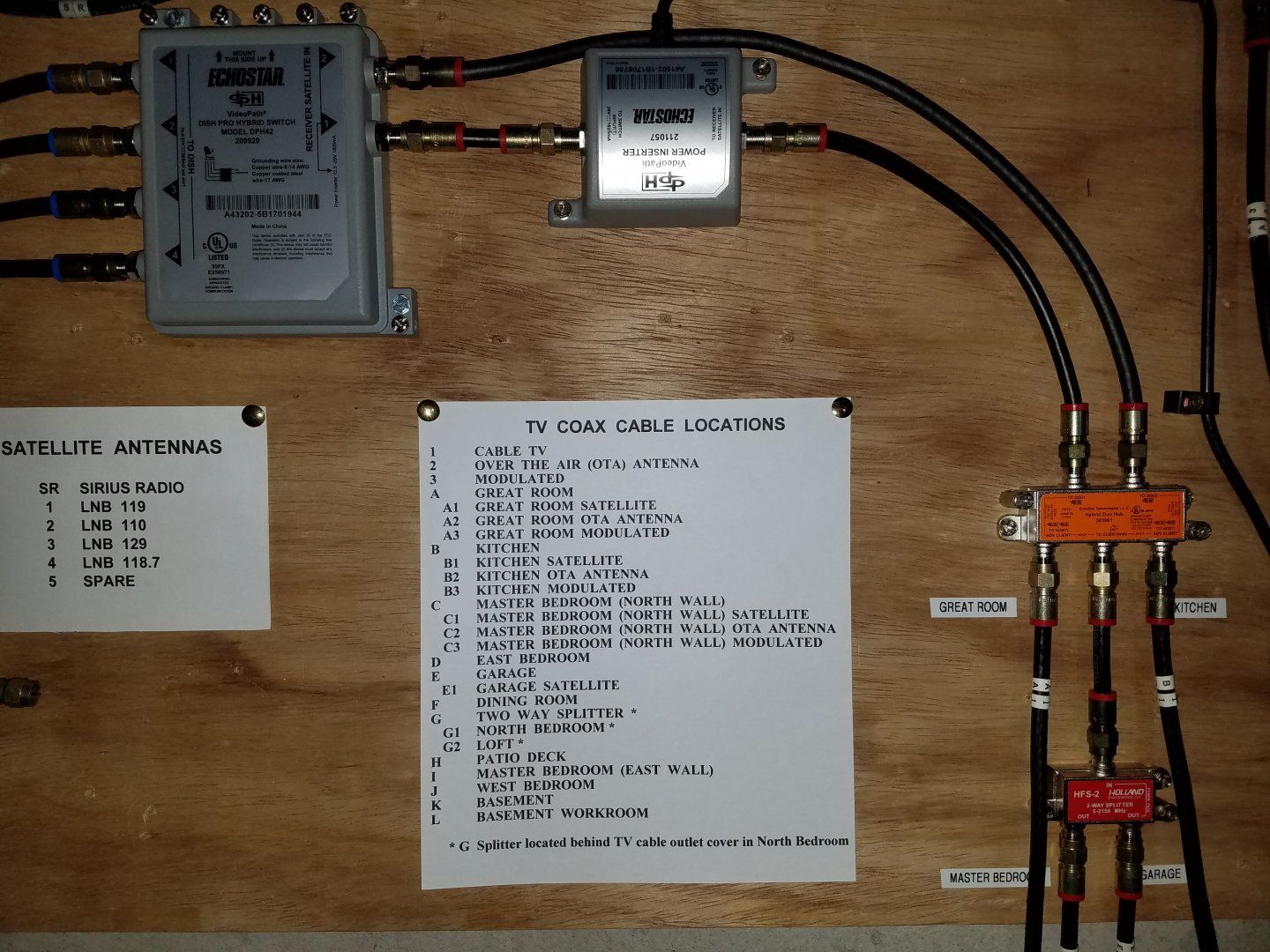

I purchased my own DPH42 switch. All it shows in the instructions is the power inserter attached to port #1. I have my switch installed in the basement at my headend board.

I had asked this question in another forum but it seems related to this thread. I already had a hopper 3 system with the EA hybrid lnb. I purchased another hopper 3 and a DPH 42 switch and got everything hooked up. Both hopper 3's are working, but after the fact I read that the DPH 42 switch will not work with hybrid lnb's. My system is working so I would like to know if there is a problem for me to continue running the system with the hybrid lnb's or if I need to change them. Thank you
