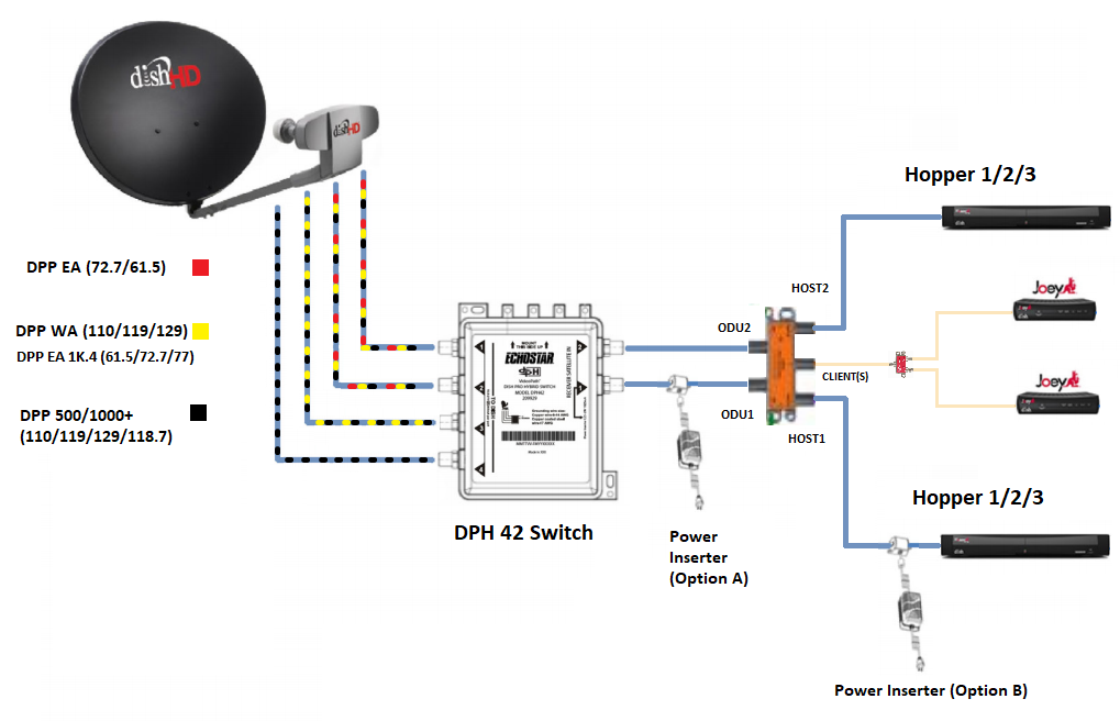

It has to be on whatever H3 line is connected to Port 1 on the DPH42 switch.

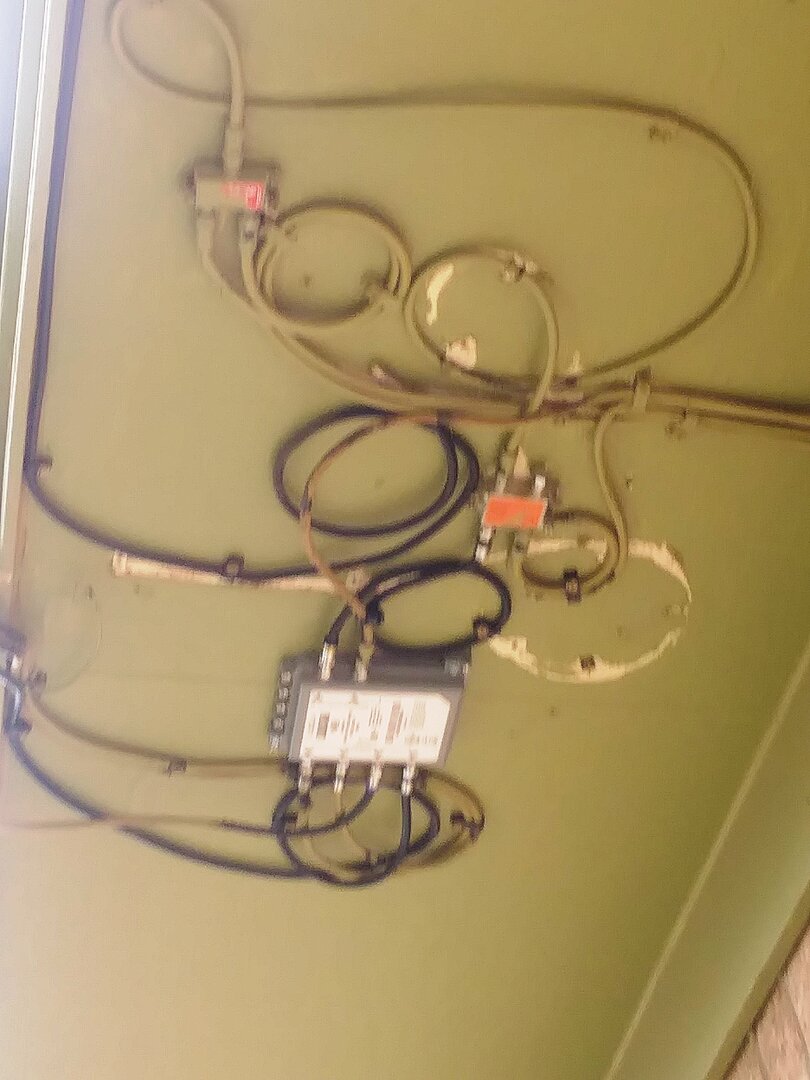

I went outside and looked at the connections. From what I can see there is a Dpp42 switch. There is no Hybrid Duo switch. What happens with the 2 other switches is a mystery to me I am amazed I have pretty good functionality . All receivers see both H3s. All receivers get all apps. However, the 2nd H3 does not see the 3 external hard drives connected to the leased H3. However, the 2 Joeys do see the external hard drives. I can only get Alexa to control the leased H3

Oh yeah, that is wrong. So no MoCA communication is happening over the two primary coax cables, instead it's going over Ethernet. It also explains why disconnecting the second H3 from Wifi/Ethernet takes it off the primary H3's network. I would call it in as being incorrectly installed, or you could probably fix the problem yourself if you get a Duo Hub, since all you would do is disconnect the H3's/power inserter and move cables around. Or leave it as is, if your home network is solid then it will work fine (Since the Joeys are still linked/dependent on the primary H3, the only heavy activity I can imagine happening is viewing the second DVR from the Joeys on the primary network, but that should be ok).

From what you posted, I would need to have the 2 other switches replaced with the Hybrid Duo Hub ; have the original H3 cable come out of the #1 port of the DPP42; move the power inserter to the original H3; and turn off bridging and WIFI to the 2nd H3. Did I miss anything?
