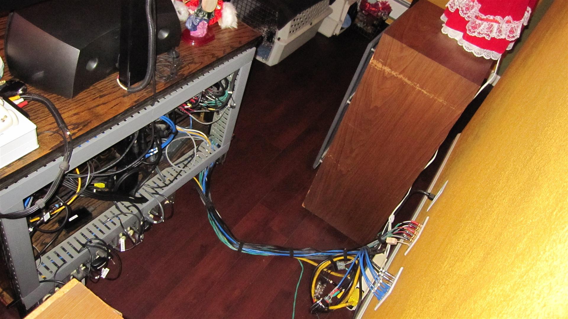

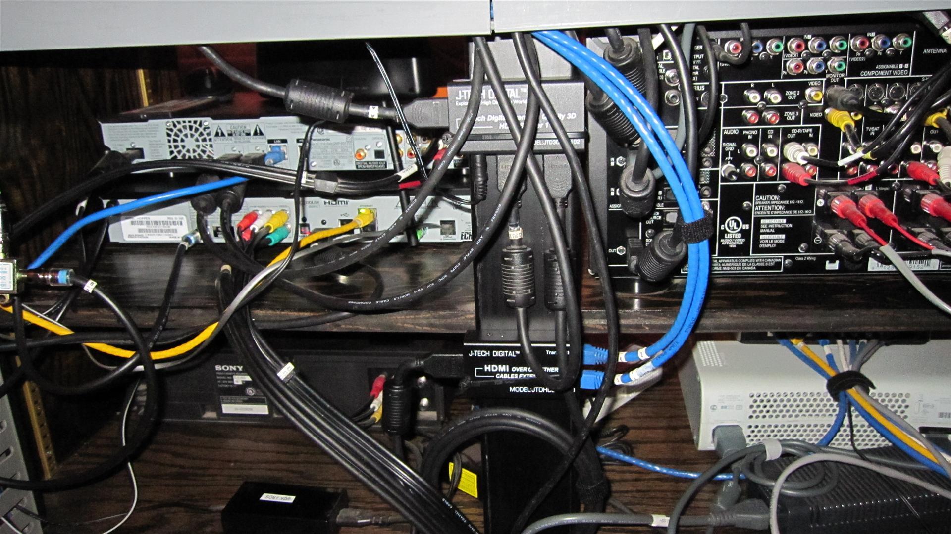

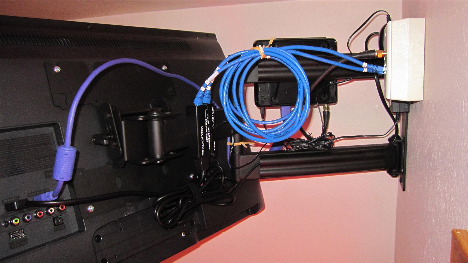

Ran HDMI from one TV to the other via 2ea Cat6 cables, HDMI splitter and HDMI extender. No complaints yet on jtech digital HDMI boxes I got from amazon. I miss spoke when I said one TV does not have component input but I used that input for our 7 camera CCTV system. I have also taken the analog R/L audio from joey and ran to wireless head phones.
