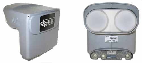

From one of the empty outputs on your DPPTwin, to the input on the receiver. It's the big thing on the end of the dish that says "DP Plus" on it.
What Pepper said. I'm just adding a picture of the DPP Twin ports. The two ports together are the outputs and the one by itself is the input for the 3rd satellite. Since you already have a 722 for one of the outputs and 129 going to the 3rd satellite, connect an RG6 cable to the only open port on the Dpp Twin and the other end to the receiver.
