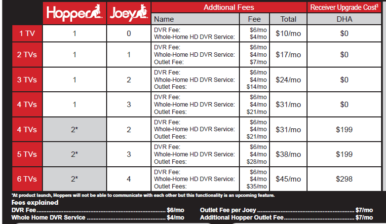

I have already purchased one hopper i am looking to get good deal on joey and then will sign contract for 2 hopper and 2 joey and in future will add one more hopper to account..
Do we have to pay anything extra for 2 hopper and 2 joey setup ?
Contact DIRT for exact upgrade costs, but it will probably be $100 per hopper like most existing customers.
there's a separate thread on the maximum limit. http://www.satelliteguys.us/hopper-zone/280552-3-hoppers-9-joeys-new-maximum.html
You should contact DIRT about it as it all goes through a special department to add the third hopper.
One Hopper is free. Each additional Hopper/Joey is $7.00 per month.
for existing customers, neither hopper is free.
For new customers, the first hopper is free with Top 200. However, the second hopper is $199.
(all assuming you qualify for the promotions)
Was talking about monthly fees, as OP owns the one Hopper.
