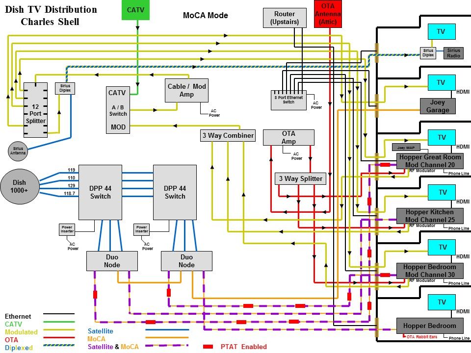

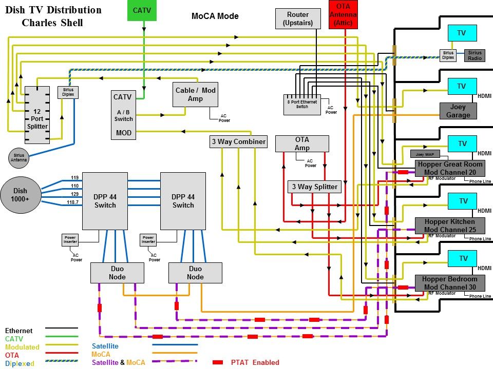

Yep, my 4 HWSs worked great and they all can see each other including my 2 Wireless Joeys and regular Joey. I have reduced down to 3 HWSs now since my kid moved out. The only problem I have that started a while back is the occasional remote control lockup. The issue is if you have two or more Hoppers in the system and rigged up so they can all see each other. Remote control lockup started after one of the software updates. Hopefully DISH will fix it sometime.

When I switched to Hopper/Joeys from VIP722s the DISH technician installed all four Hoppers and Joey. I had two purchased Hoppers waiting for him when he arrived and also three OTA modules. Technician installed everything. I already had installed two DPP44 switches and two Dual Nodes before he arrived. He was surprised all four HWSs could see each other.

I currently have 2 hoppers and 3 joeys. I want to replace 1 joey with another hopper to get more tuners. I have spoke with 2 dish reps and both told me that I can not add another hopper, that 2 hoppers are the max. I have seen post where people said they have 3 hoppers. How do I get the 3rd hopper if dish will not activate it on my account?
jeffcustom, purchase your 3rd Hopper and then PM a DIRT member to help you with the activation if needed. Here is my diagram of a 4 Hopper setup if it helps you any. Also a diagram of my 3 Hopper system since I have reduced down to 3 HWSs.
