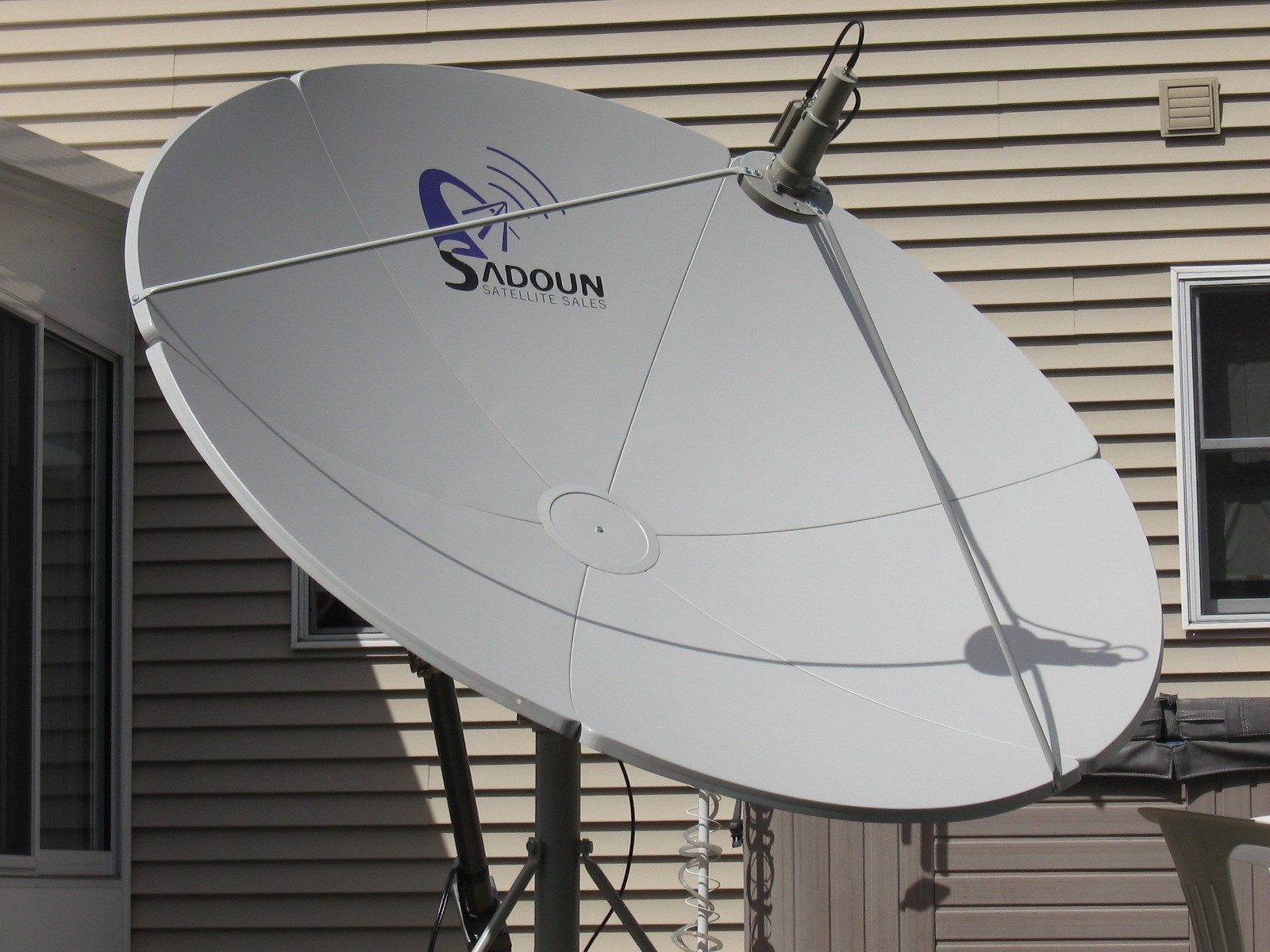

Heres a pic of my 6 ft dish!Just dont tell sadoun that you might paint over his name :D
