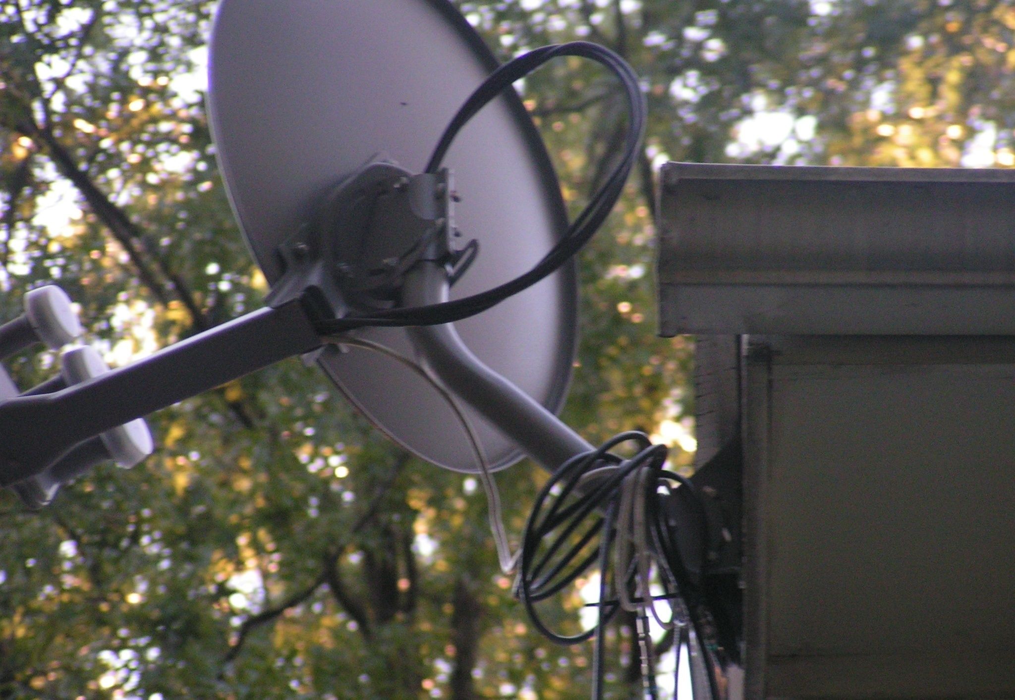

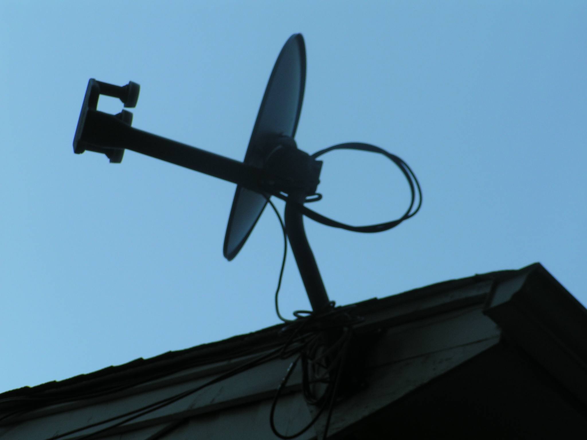

I have a 3 LNB installed by Robert's guy about 2 years back on side of my roof, they did a great job and I have no issues for 2 years.After 2 cancellations I finally had someone from DirectTV's DirectTech subcontractor at my place to do the install of 5 LNB dish.
The installer said he will be unable to install on the side of the house as the new dish is 40lb & can not go on side. He said he needs to put it on Roof and if he puts on the roof then I will not get signal from 119. Installer and subsequently DirectTV installation support said that his supervisor will review and based on the description it may an issue of no line of sight issue and I may not be able to get 5 LNB unless I shop the tree in front of the house.
Can someone tell me what my options are? Is there someone in DirecTV who really care about these things? The person on the line from their Installation Support Group did not care and so did the DirectTech guy.
Thanks

If you install an AT9 where the Phase 3 dish is, on the rake board, it will not be stable enough. It looks like he could put it on the roof just above the present location. I ASSUME he did a sight survey and that's why he said there was a tree in the way. If so, it must be very close to being in the way of your present dish.
Thats why we hate to install new 5 lnb dishes. Its not just an upgrade its oftentimes a complete reinstall because we have to find a new location sometimes do a pole mount and therefore rerun all the cables going to the house.
I suggest stay with 3 lnb dish because right now it gives you same channels as 5 lnb dish. 2 new satellites arent even working yet. They supposedly will add more channels in the future but for now you are good.
What about sistering a length of 2x10, say 1 1/2 to 2 foot, on the rake board? Painted the same trim color and you'd hardly notice it. Make it long enough to catch at least two roof rafter ends and screw it into them plus a couple of other places along the length. The 2x10 should be strong enough to hold the 5LNB. Of course that doesn't help the LOS situation if that's a problem from that location.

To the OP - MANJO62; have you looked into an eave mount for the side of the house? There are a myriad of options and I would urge you to seek other professional installer opinions OUTSIDE of "normal" channels where guys all from the same company will just be backing up what the other said for the heck of it. Whether or not you NEED the 5 LNB dish now is not the issue; the issue is at some point soon you will need it, so you had best get all this figured out now as opposed to waiting.

My 5LNB (AT-9) dish is mounted on the side of my home. Stable, solid mount with two stabilizer bars. What was the side mount problem he had?:confused:
That was his problem; he said he can not get stabilizer bars installed. I guess he was not to keen to go on the second floor roof and try to install it at an angel. He said he was not tall enough. I am in NYC metro area; I am supposed to get HD Locals in MPEG4.

Have you looked at a separate eave mount? Keep in mind that nearly all installers are contractors; not really employees of DirecTV and they get paid per job. Some "lazy" ones don't like to mess with anything that looks lengthy or troublesome; and I follow that with MOST are not that way, but you can get caught up in a company that seems to be overrun with lazier workers; that would put all the blame on the contract company boss. Same as with every other place you deal with in life. Do you still have the contact info of the guy Robert sent out? Its always wise to keep hold of such info when you find someone that does good work.
